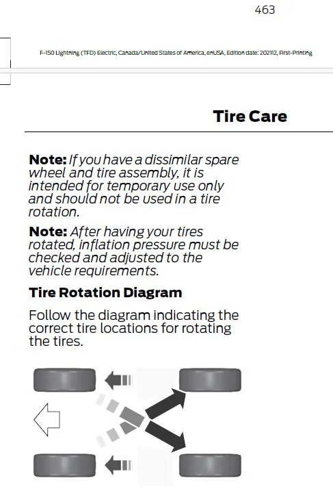

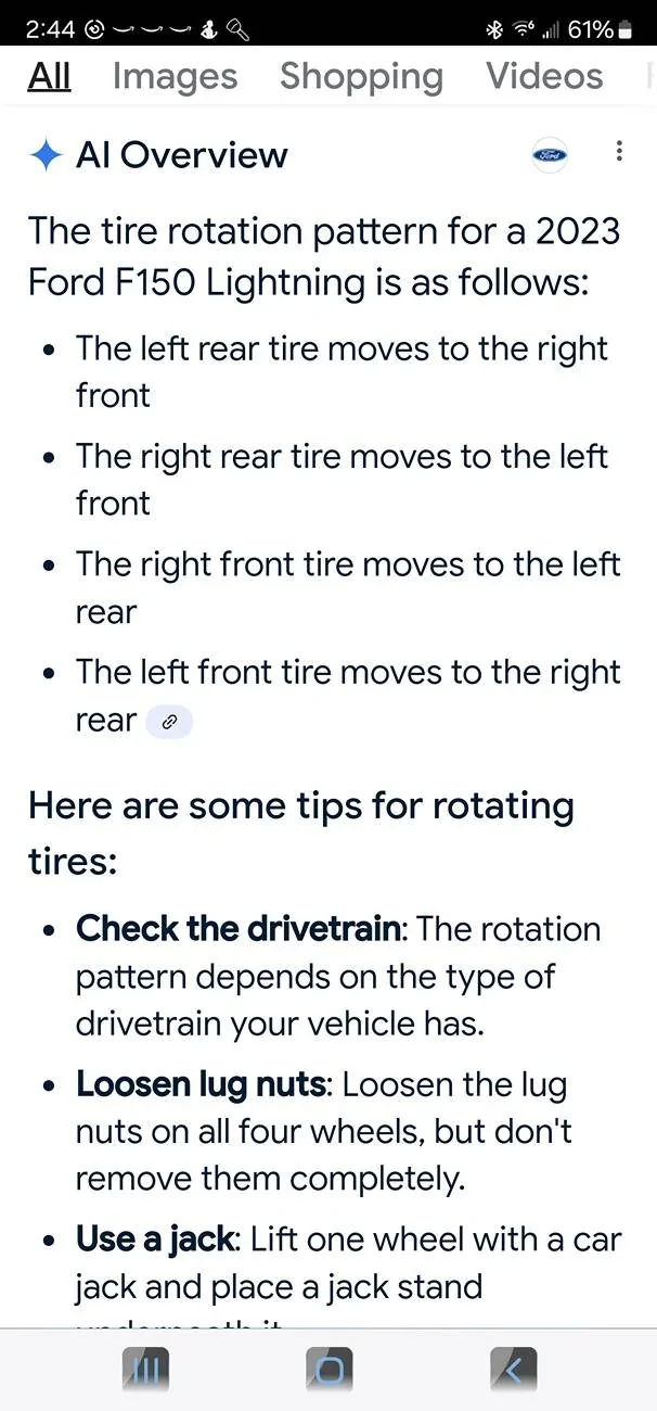

Can't imagine why anyone would ask AI how to rotate their tires. That rotation is NOT correct.
Manual is quite clear.
The fronts are crossed to the backs, and the backs are brought forward.
I did find this in the small manual and followed it. At 13k, my tread depths were 7/32 for the front and 9/32 for the rear with slightly more on front outer edges. I did have to retrain TPMS to get wheels to be recognized in appropriate positions.
BTW: I posted the tire info to Ford Service History for my vehicle via Ford Pass.
Original Tire Location
Front Left - 7/32 to RR
Front Right - 7/32 to LR
Right Rear 9/32 to RF
Left Rear - 9/32 to LF
Train TPMS after rotate
