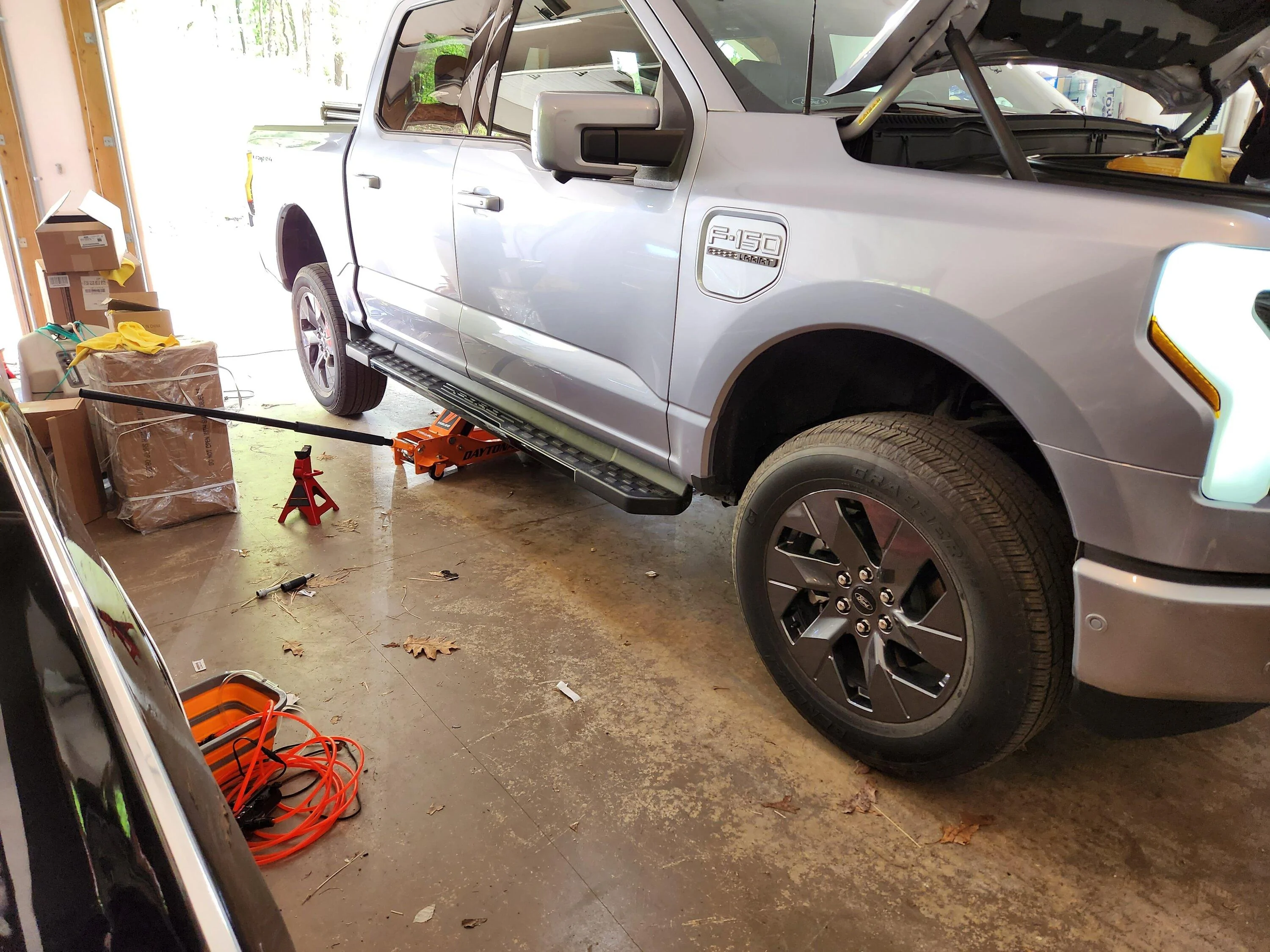

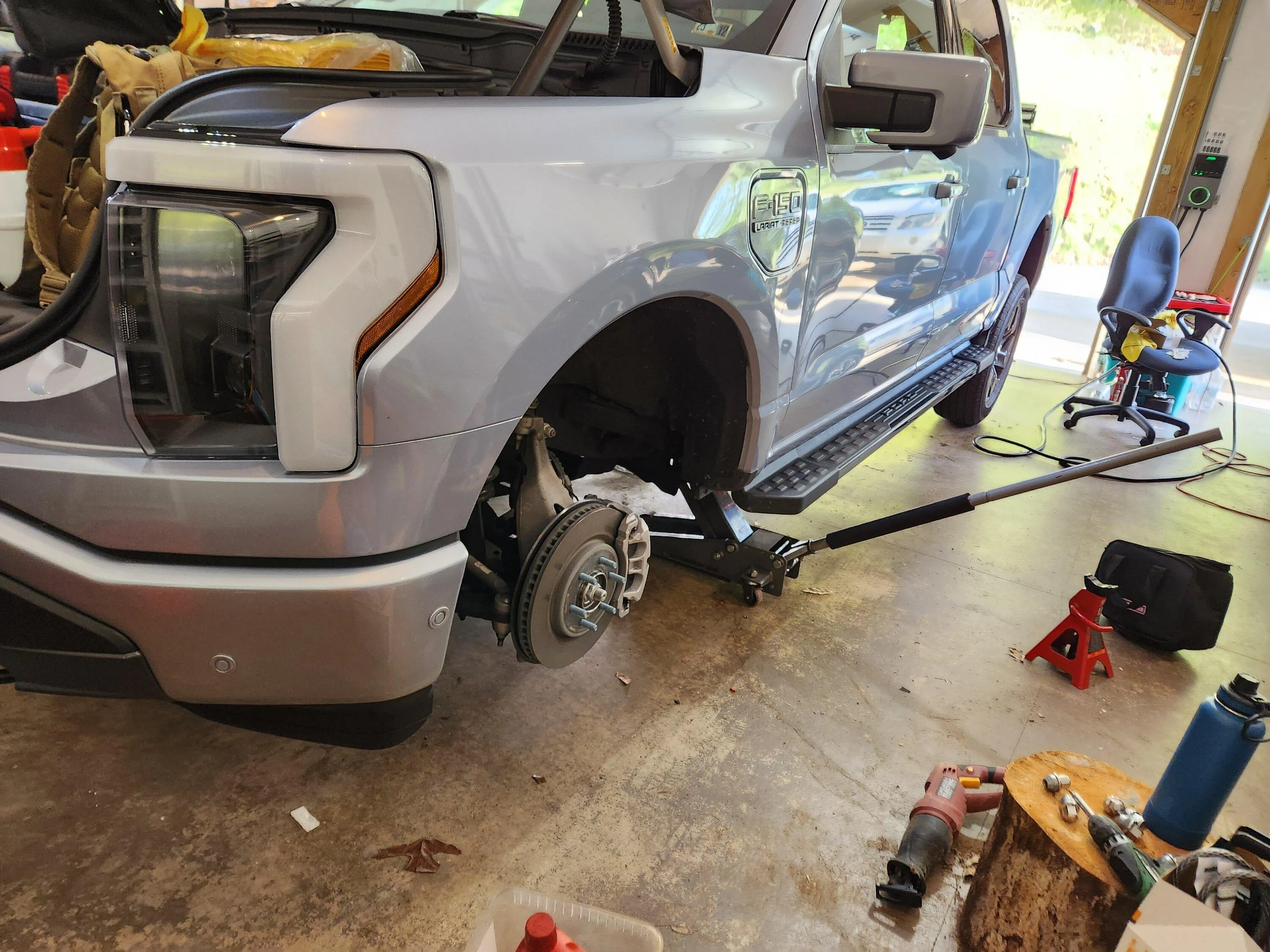

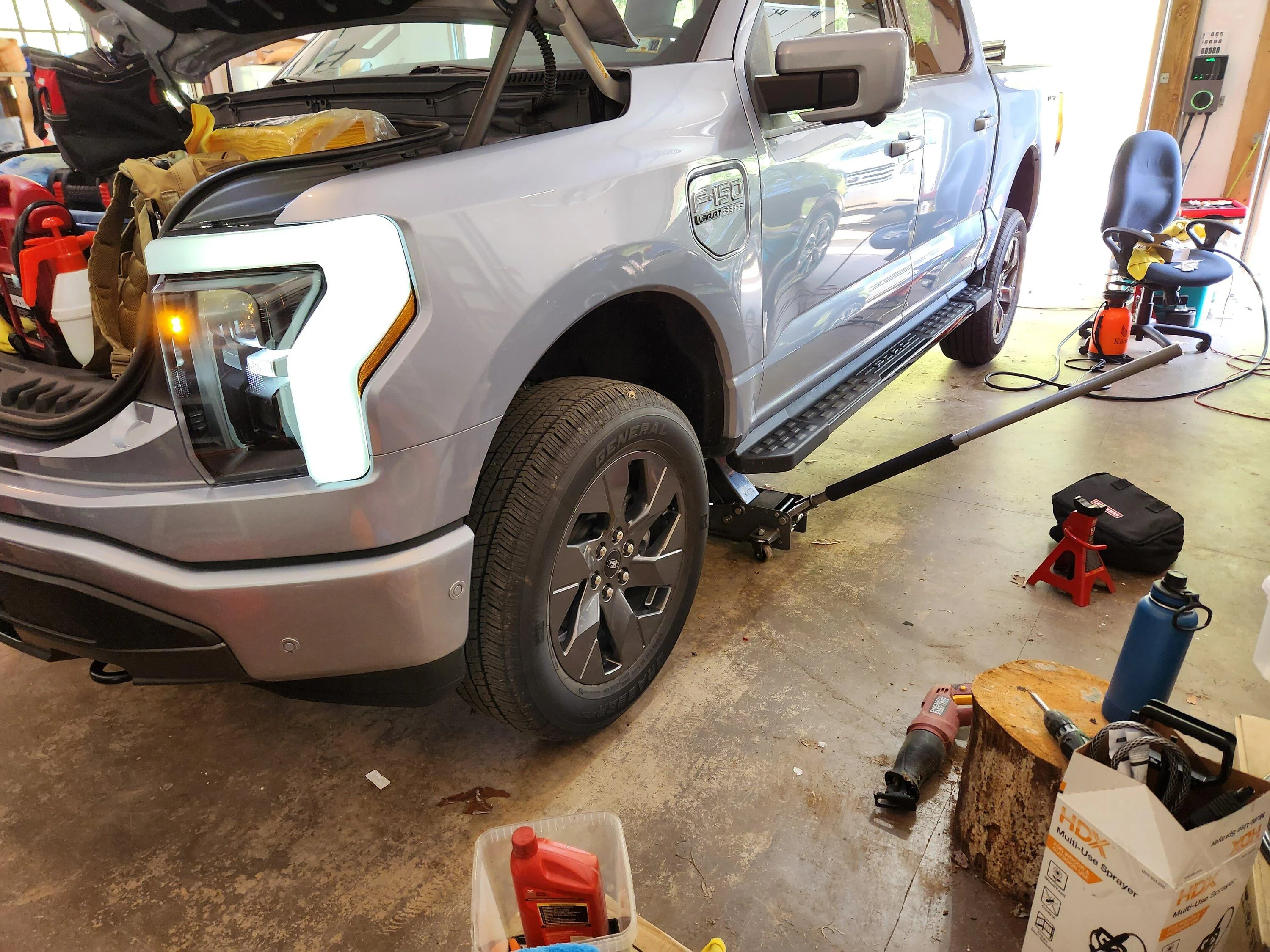

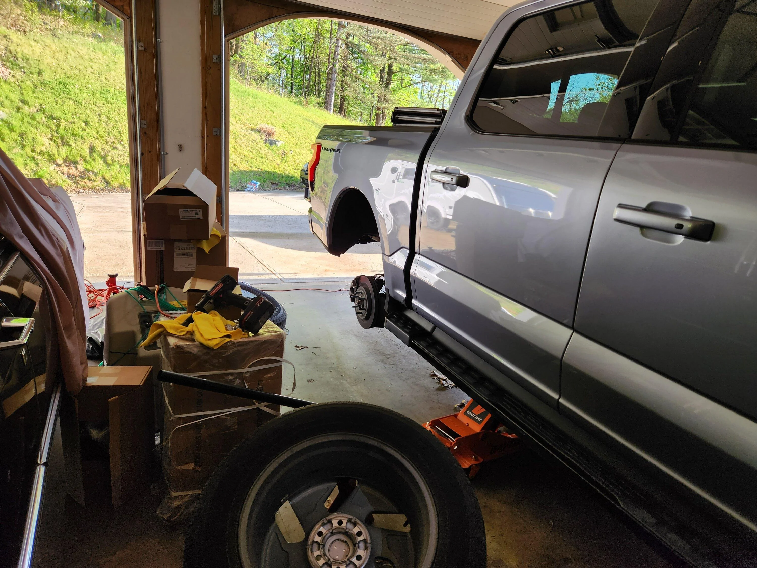

After reading a previous post about how the underbody shielding made it almost impossible to use a floor jack to get the truck supported on jack stands, I decided to try it for myself and tackle a home tire rotation today. It's true that the underbody shielding blocks most of the frame rails on both either side and take away one of the biggest advantages of a full-frame vehicle: lots of jack points (almost anywhere on the frame rails).
So being that I didn't really feel like unbolting and removing the plastic underbody shields along the frame rails and that I had two floor jacks, I instead devised a solution using both floor jacks. (This is to perform Ford's recommended x-cross rotation, if doing simple front to back, it's a much simpler process)
1. I lifted the driver's side front corner and passenger side rear at the same time.
2. I then removed both wheels and moved the drivers side front tire to the passenger rear position and tightend the lug nuts
3. I then lowered the passenger side rear, while leaving the driver's side front up in the air.
4. I then moved my second jack over to the driver's side rear and lifted it up and removed the driver's side rear wheel.
5. I moved it forward to the driver's side front position, installed it and torqued the tightend the lug nuts.
6. I then lowered the driver's side front and raised the passenger side front while keeping the driver's side rear in the air
7. I raised the passenger side front, removed the wheel and installed the passenger side rear wheel on the passenger front position and installed the passenger side front tire on the driver's side rear position.
8. Finally I lowered both corners back onto the ground and properly torqued all lug nuts in a cross-pattern with a torque wrench.
Complicated? Maybe. Annoying? Definitely. Better than removing plastic shields? Well at least I think so!
