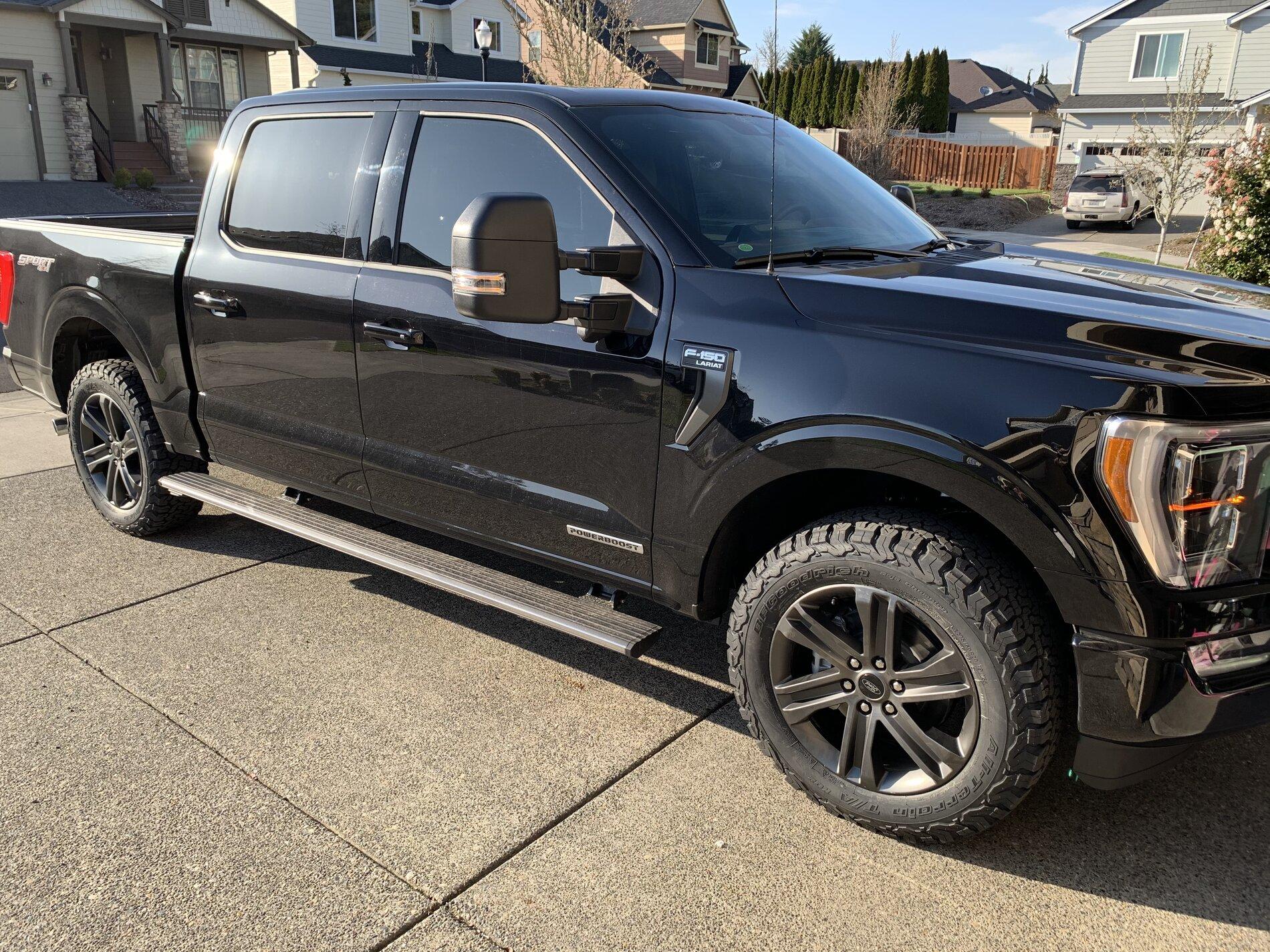

I ordered some black 3M wrap. I’ll try it myself it was only a $15 investment. I’ll report how it turns out.
That sounds better than $150 for a dealer to do it. Very interested to see your results.

Dealer confirmed that those first two links are universal for both powered and non-powered tow mirrors. Part numbers are 17D742 and 17D743. They are ordering mine and will be using the points from the truck purchase to pay for them.

I have the black caps in hand now, but I’m actually starting to like the one chrome accent on the truck versus going all black. Going to sit on it for another few days, but I may return them.

I swapped mine out. My local Ford dealer had the black ones in stock. There is a YouTube video out there that I followed. Its the same part and procedure of an F250.
The Ford part number for the "black" ones are part number HC3Z-17D742-AA. and HC3Z-17D743-AA

Here is the video, its not the best but you should be able to get the idea. Unfortunately the bottom middle tab gets broke but the procedure for taking the cap off the Ford way is lengthy and requires removing the glass and potential to break lots of other expensive plastic and glass parts. I decided sacrificing the 1 bottom plastic tab on the ones I was removing was worth it.
