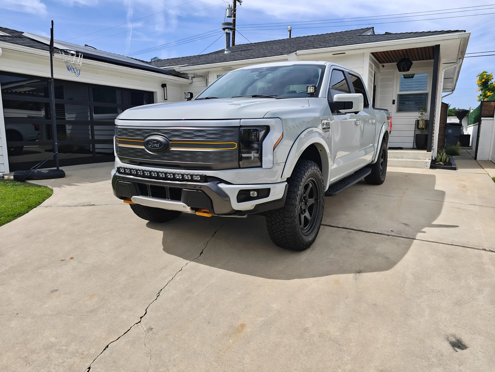

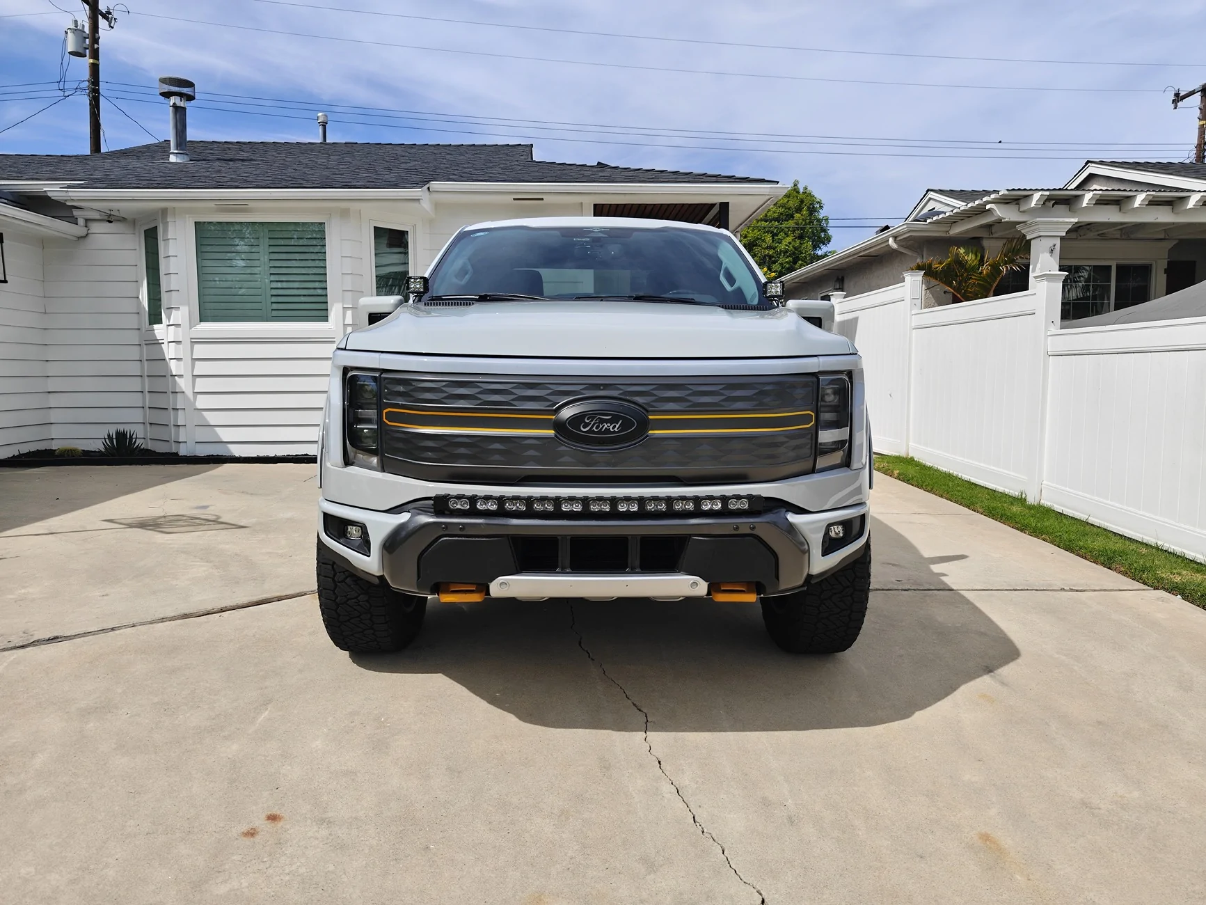

Your welcome! I updated the initial posts. I dialed in the fit and added a light bar.

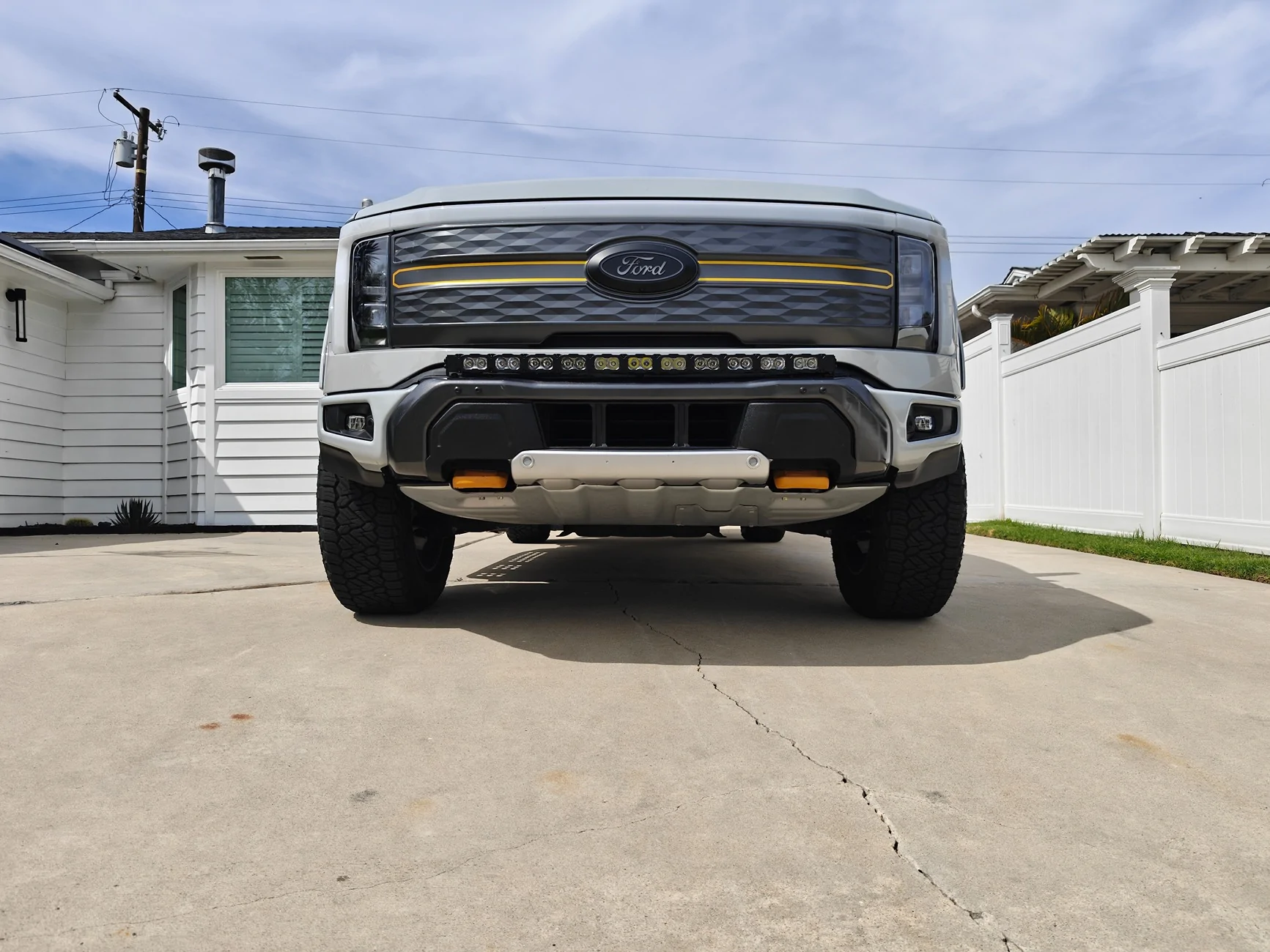

The there's definitely room for a light bar. But the opening is not as wide. I had a 22 inch light bar in the lightning bumper, it wouldn't fit, too wide. There's also no plastic box in the opening to mount the light bar. I think the best route would be to buy a kit, there's a bunch out there for the modular bumper. It comes with a new grill opening for the bumper. The new grill has a mount for the light bar and usually includes the light as well.

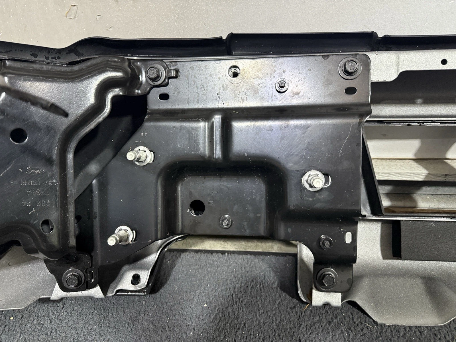

Tip for the eBay listings, make sure the 2 bumper mounting plates are included. Lot's of them available don't include them. Look at the pictures of the back side and look for plates with 3 bolts sticking out. Example below.
As for the skid plate it was not a simple bolt on for me. I had to trim the rear and front to make it fit. But the bolt holes lined up in the front, I had to widen them in the rear. You might be able to do less trimming in the front, I originally had my skid plate on the original bumper. Search on this form, there's a thread specific to the skid plate I think.

EDIT: Wanted to add my truck started as a Pro. If you have the Lariat or Platinum this bumper might not work. It only has 4 front proximity/radar sensor holes. I ended up adjusting the fit and adding a light bar. I noticed the bumper was sitting too far in and angled up. Also my skid plate needed to be angled down and tucked inside the bottom of the bumper. To fix the fit I added a quarter inch spacer on the 4 top bumper bolts, nothing on the 2 bottom bolts. To angle the skid plate down I added 1.25 inch spacers to the rear 2 bolts.
I thought my Tremor build was complete until I saw another lightning owner post his modular bumper install a few weeks ago on Reddit. I can't take credit for being the first. I'm stoked how it turned out. It really finished up the build and looks oem. I think if Ford built this trim it would've looked pretty close to this. Part list below. The Modular bumper is 3 sections, the 2 side "wings" and a center section shared with the Raptor R/37 and Tremor 402a package. It has mounting points in the center for aux lights, bull bars, or even a winch. The tremor side wings have single fog lights. You'll probably want to mount a Raptor skid plate to complete the look. I mounted one up previously, trimmed for the stock bumper. You can get it looking better if you trim it for the modular bumper. Mine has a bit of a gap but I don't feel like starting over. I painted the side wings avalanche, center section magnetic gray, and the lower part ingot silver to match the skid plate. The bumper sections came black.
As for the parts, it's easier and cheaper to source the center section from ebay. Most are dealer take offs. Look for a Raptor 37 or Raptor R used bumper, the base Raptor bumper is one piece, won't work. Make sure the one you pick comes with the 2 bumper mounts. On the pictures of the back side, look for plates with 3 long bolts sticking out. Also make sure it comes with the center grill trim and the 2 covers that go on the sides of the center grill. Lastly see if it has the radar mounting plate. Your going to discard the raptor side wings and mounting brackets. Save all the hardware, you reuse some when mounting up the tremor side wings. I was able to find the fog lights new on ebay sold as a kit, China knock off. It came with the brackets. The rest of the parts I bought new from ford. If your shopping online watch the shipping charges, that's where they get you.
For Install, you have to remove the frunk tub, upper facia, and the mounting bracket to reach the bumper bolts. I removed my wiring harness from the stock bumper and wired it up to the modular bumper. I was able to swap the adaptive cruise control radar to the modular bumper, but had to swap it to the mount specific to the modular bumper. Luckily my ebay center section came with it. When mounting the modular bumper up I left the side bumper wings loose, tip from the reddit post. Then tightened them after I got the bumper tightened down and the upper facia installed. The only problem I ran into was getting the upper facia back on. It's a very tight fit with the modular bumper, pain in the ass. I hope I never have to take it back off. I ended up trimming the rubber pieces on top of the side bumper wings. After lot's of curse words and sweat I finally got it seated and clipped in. Maybe you could put the facia on first and then mount the bumper, tighten the bolts from underneath. I was too stubborn to back track and start over at that point. I wired the fogs to my aux switches.

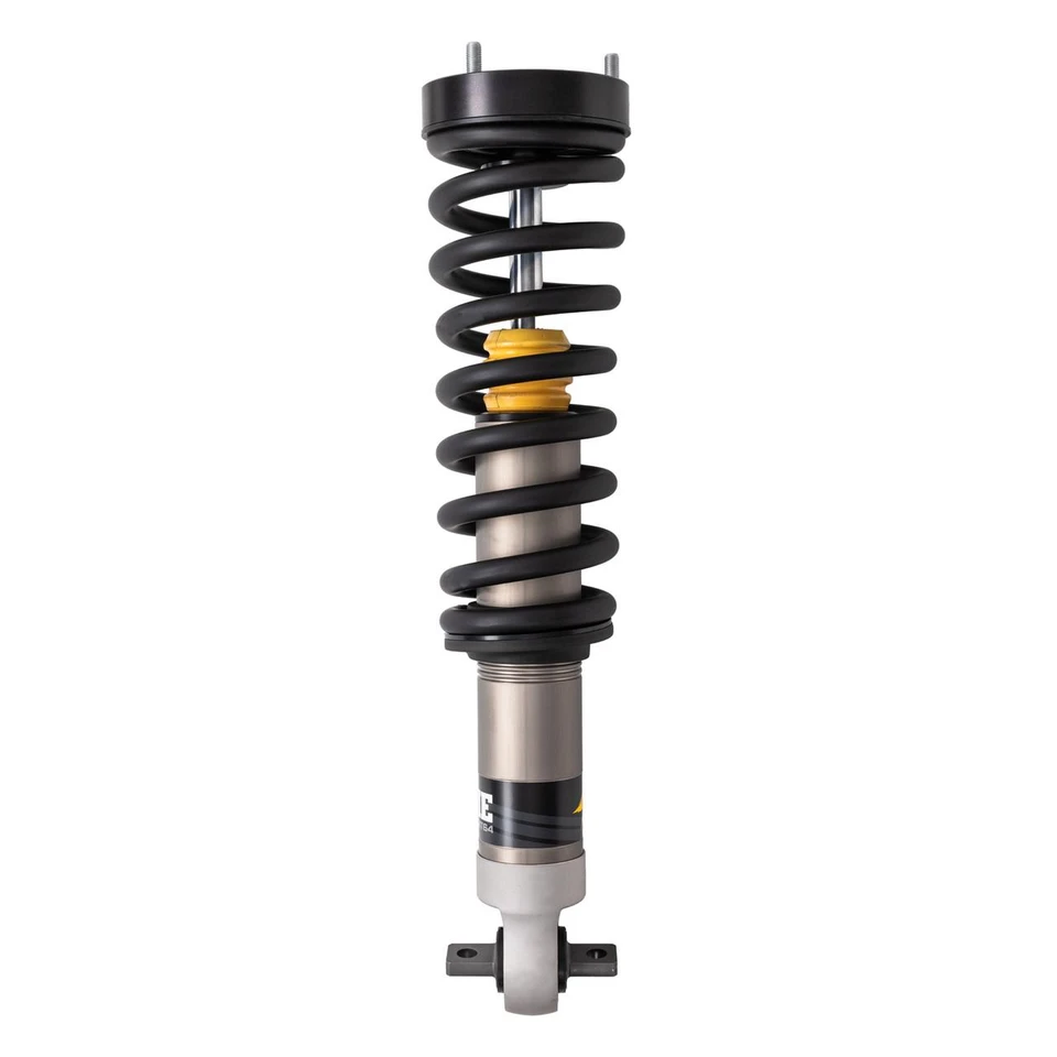

For the suspension, your building a more true off road set up, I agree the Eibach wouldn't be ideal. Have you looked at Bilstein 6112's? Also ARB now makes a sweet front shock for the Ice trucks that should mount up no problem, a bit pricy though. For the rear you might be able to figure out a way to swap a comparable Ice shock that meets the specs.
Arb shocks
https://store.arbusa.com/coilover-strut-front-2-5in-mt64996008-mt64996008/
