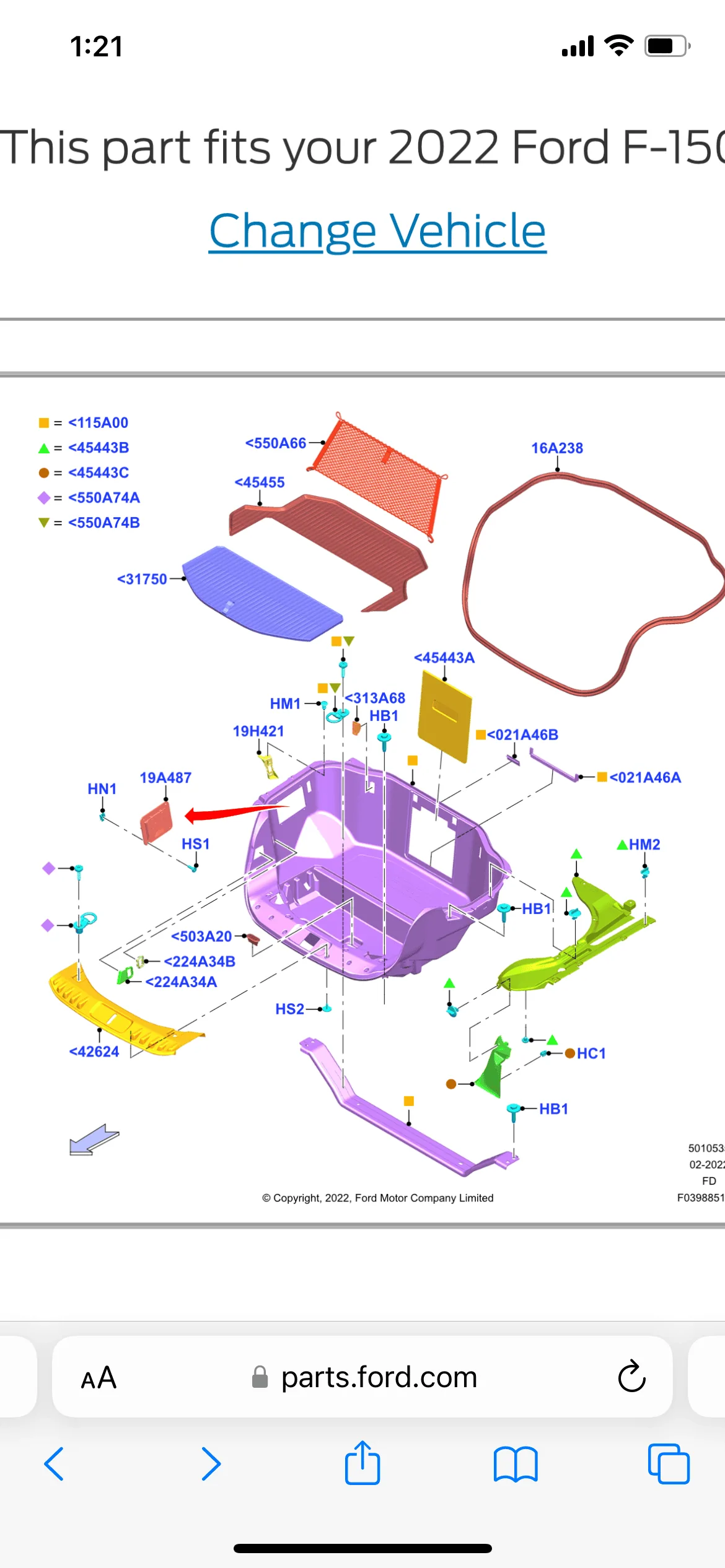

Anyone know the part number for the twist clips that hold the covers down under the frunk . I was checing my battery coolant and brake fluid level and when I lifted the cover one of them fell down inside somewhere.

Not sure which one but fords part site shows W711193 and W710282 for the same part.

That’s awesome where are you finding these graphics?

parts.ford.com it’s actually a pretty awful site as it doesn’t give you the full part number.
I'm pretty sure they're the bright green triangles, showing as 45443B in the legend for that graphic. Add 'very fragile' to 'easy to lose'. :(
The triangle is actually the side cowl and is $135. He’s looking for HM2 in the graphic which should be one of the above PN’s.
