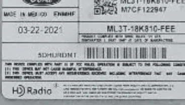

I added the HD radio to my lightning, but I used the -FEE version. It looks like there are more of those available on eBay. There is one on there this evening for $150 (Search for item #204846049414)
Ford F-150 Lightning Update to HD Radio - Correct ACM? 1720833556693-h7
I think if you see the HDRadio logo on there in the pictures you'll be good to go. There are a few different versions of the ACM including diversity receive antennas.

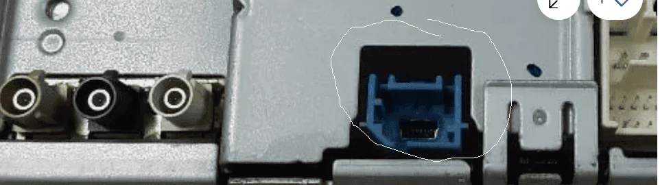

Near as I can tell - I think you'd want to make sure it has the A2B port on the back - that's used for all of the B&O systems with the rear amplifier
Ford F-150 Lightning Update to HD Radio - Correct ACM? 1720833638858-8c
(you don't need to use the port - I am just saying it's another way to identify the B&O ones.) The ACM still has speaker level outputs that you would turn on with Forscan. When I upgraded I:
