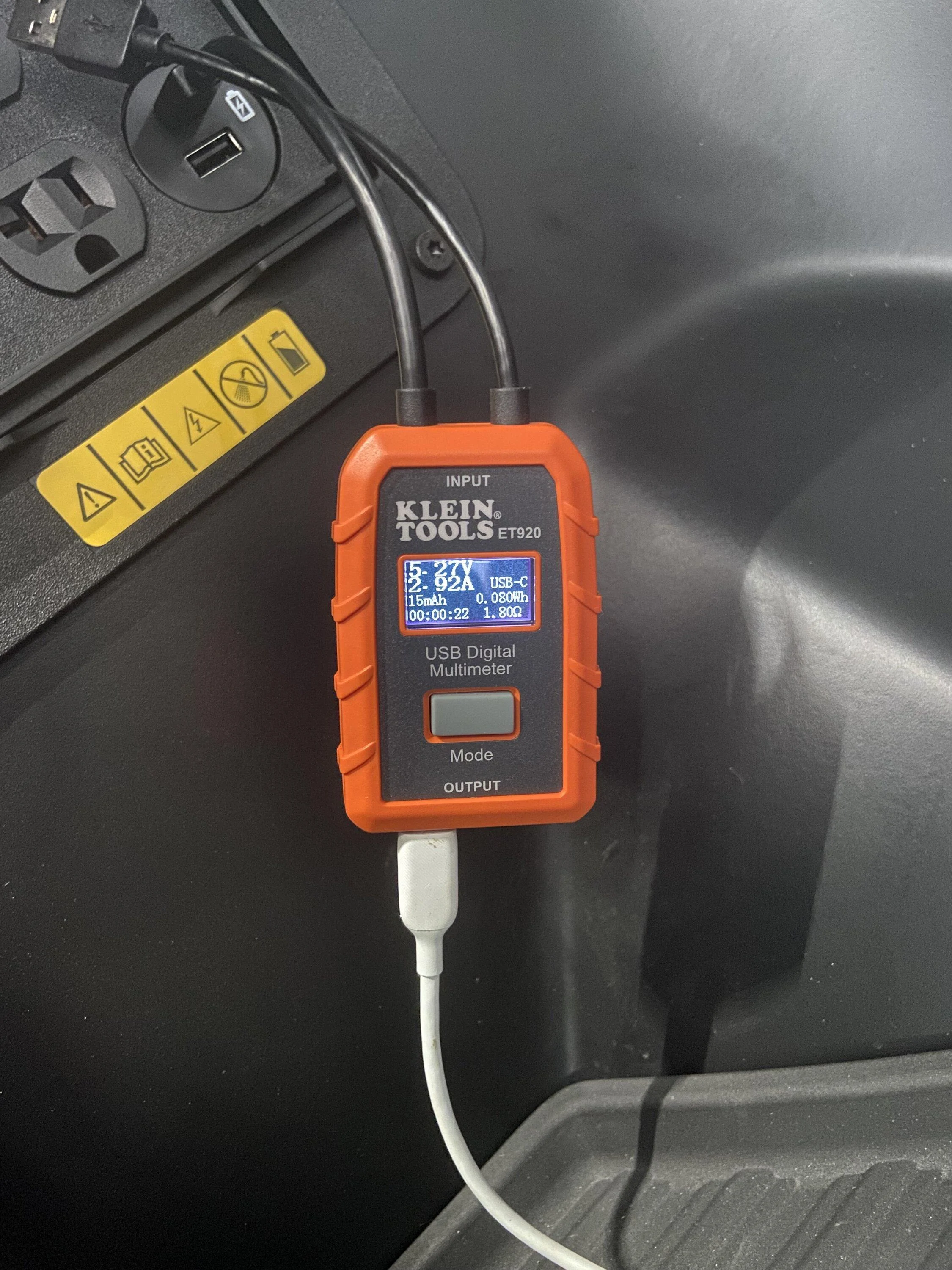

I couldn't find if anyone has done this yet, so I hooked up a Klein USB meter to each of my 2023 Lariat USB plugs and here are the results:
Plugs right below the main touchscreen:
USB-C: 15W (5V/3A)
USB-A: 7.5W (5V/1.5A)
Plugs within the center console:
USB-C: 15W (5V/3A)
USB-A: 5W (5V/1A)
Plugs for rear passengers:
USB-C: 15W (5V/3A)
USB-A: 5W (5V/1A)
Plugs in frunk:
USB-C: 15W (5V/3A)
USB-A: 5W (5V/1A)
So the USB-C is definitely faster, but unfortunately the plugs do not support power delivery with higher voltages. I used a newer iPad at a low SoC for testing, and verified that it is capable of requesting over 20 watts @ 15V to ensure I was maxing out the output. I didn't have the capability to test whether the outlets share any power, so I'm not sure if you could pull a full 4A with two devices plugged in.

Well done. I was thinking of testing them with my gear, but it's not as comprehensive as the Klein. Mine can only measure how much a device pulls, not the max the outlet can push.
