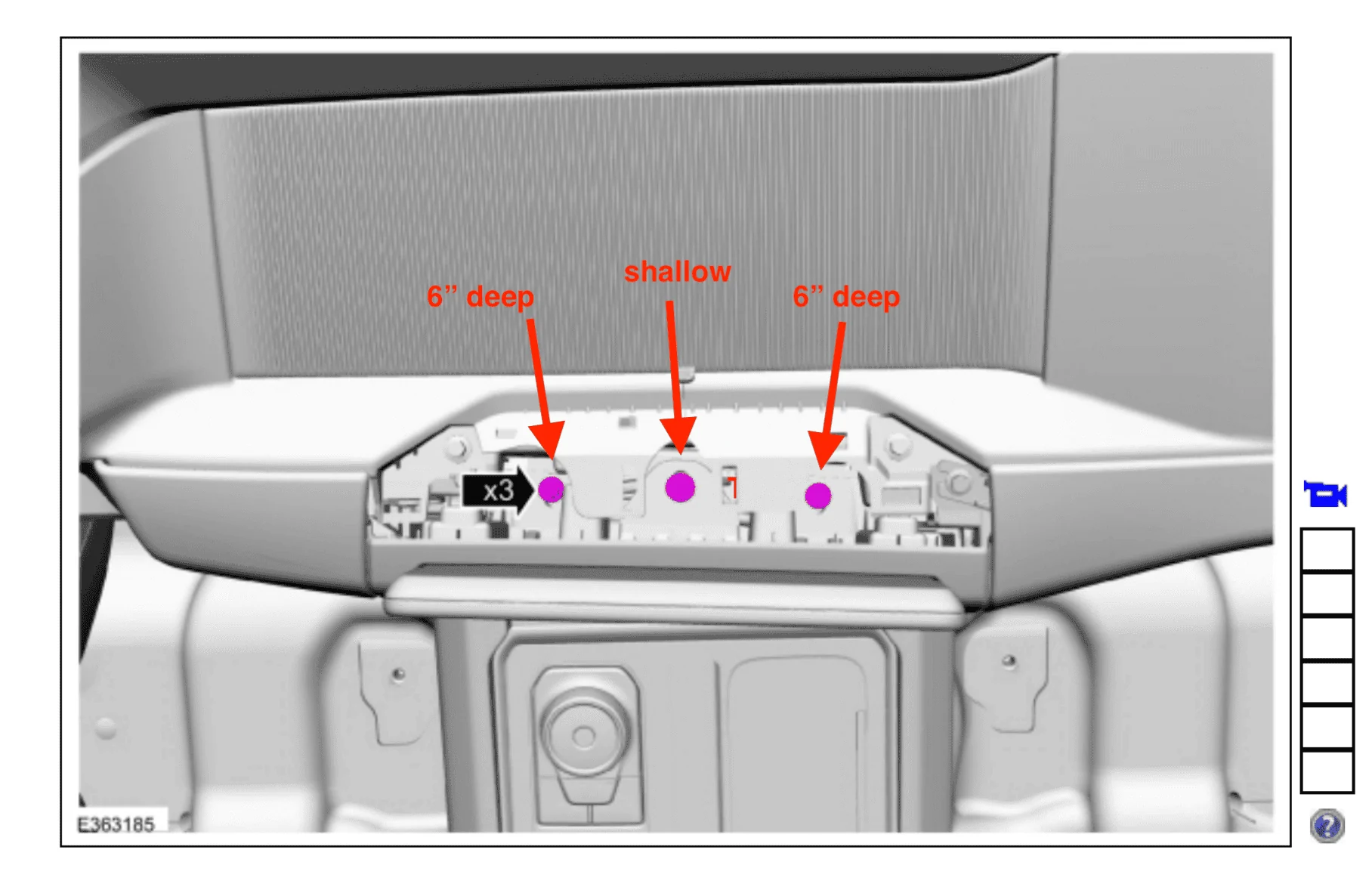

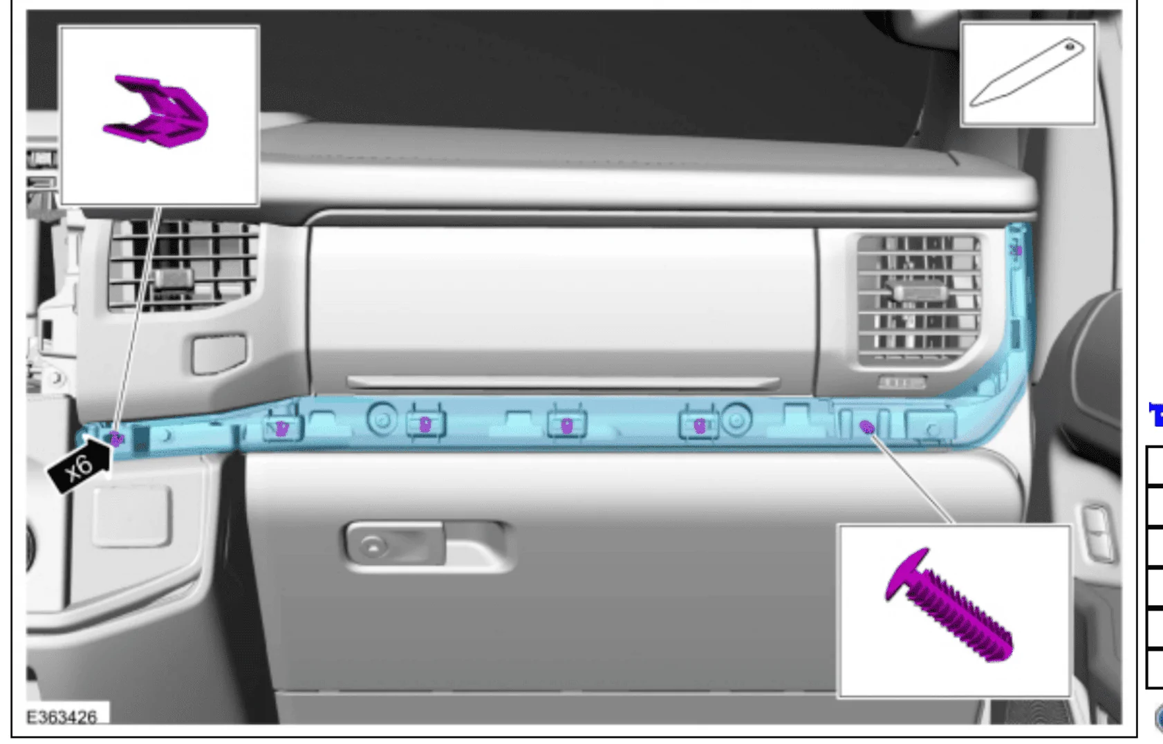

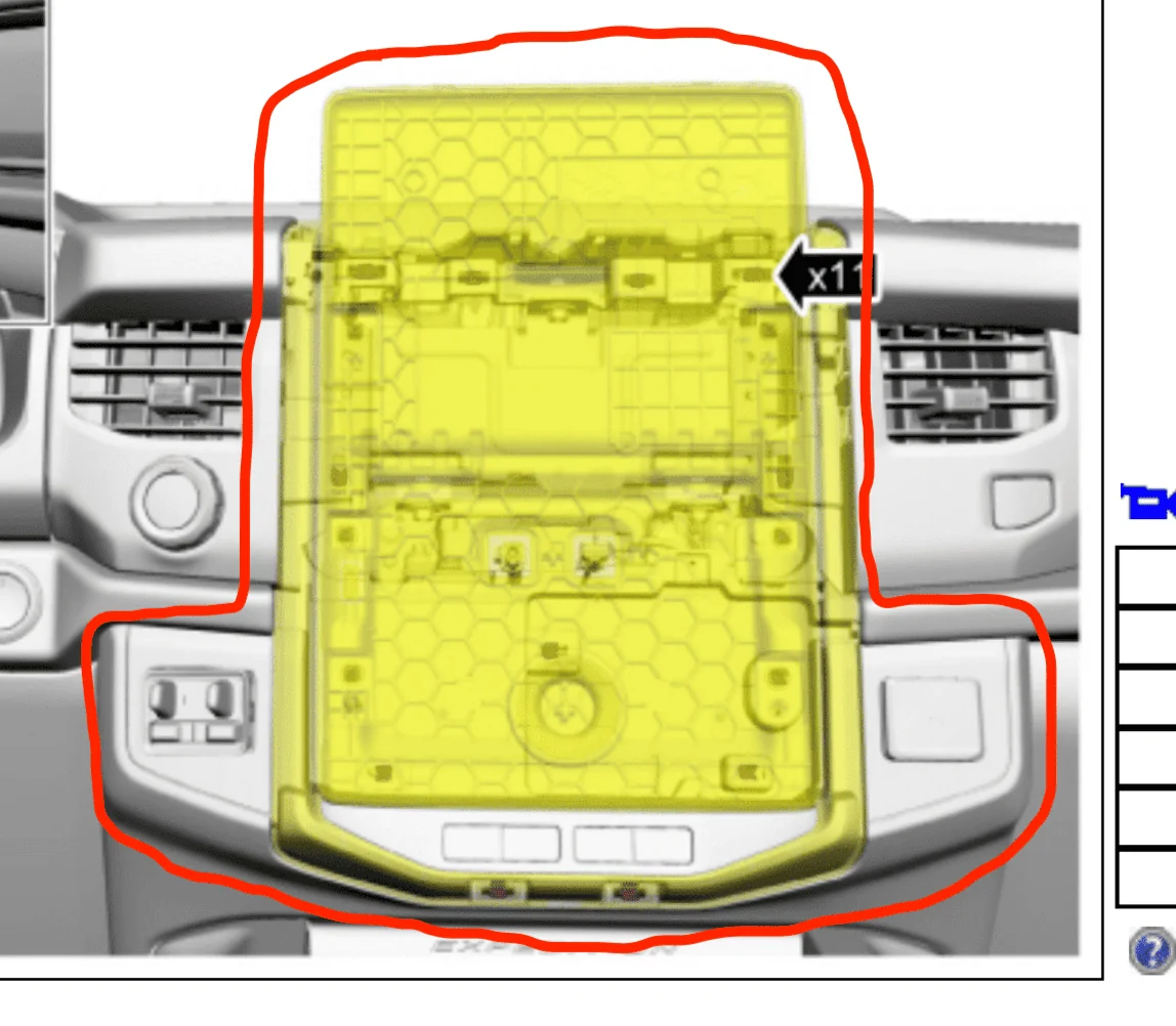

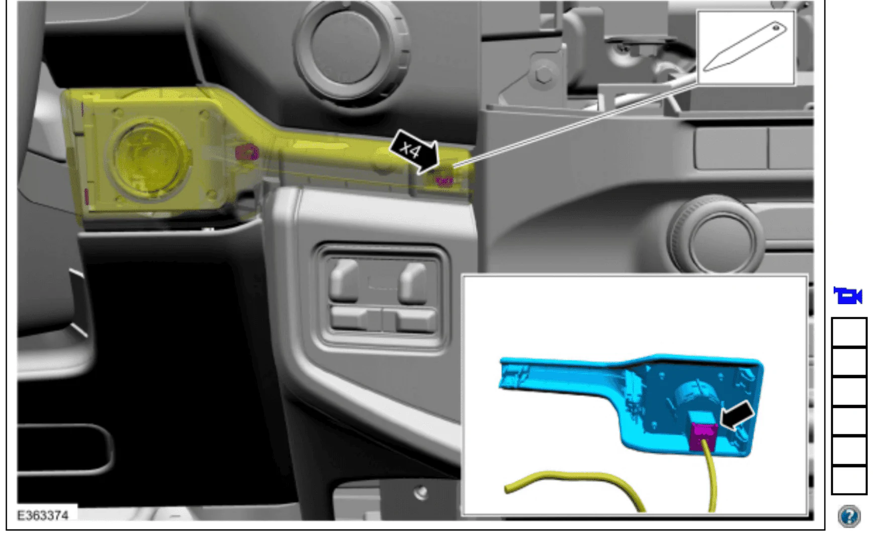

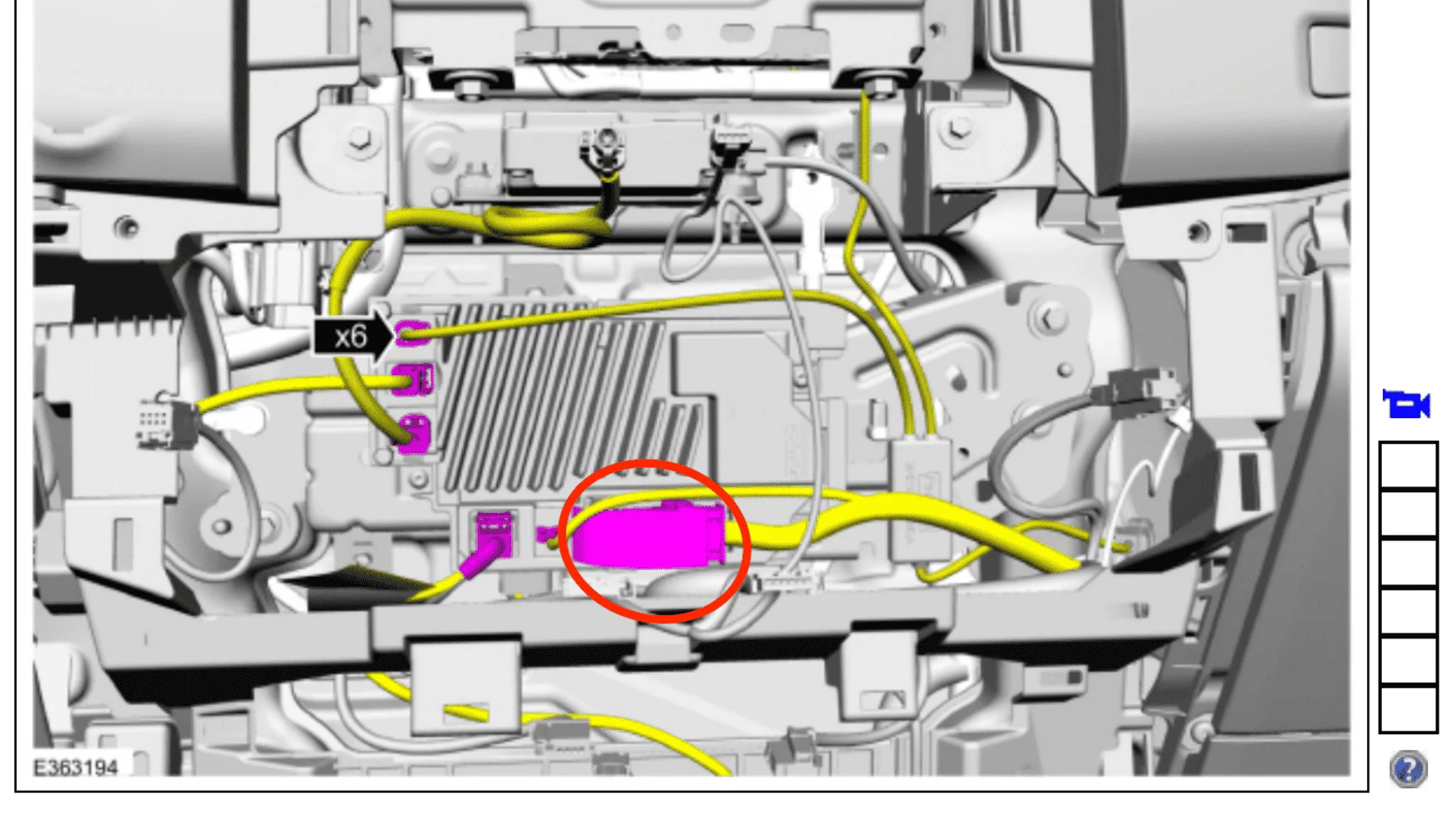

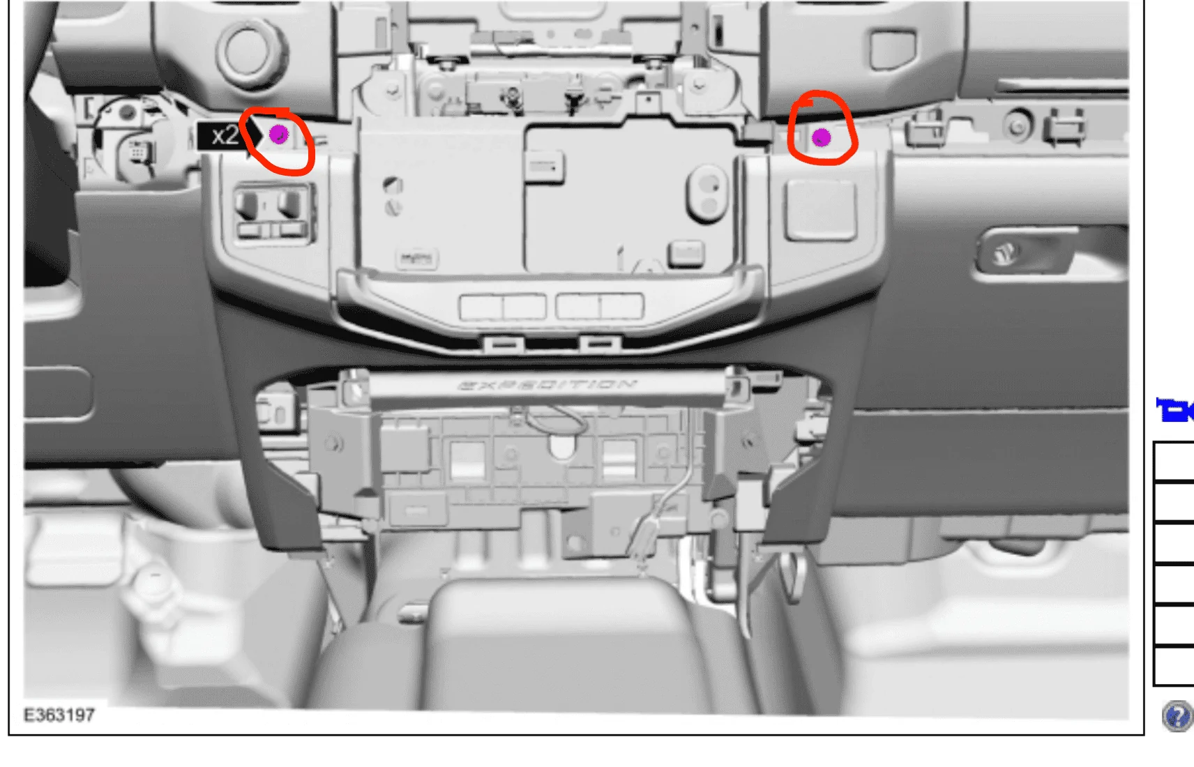

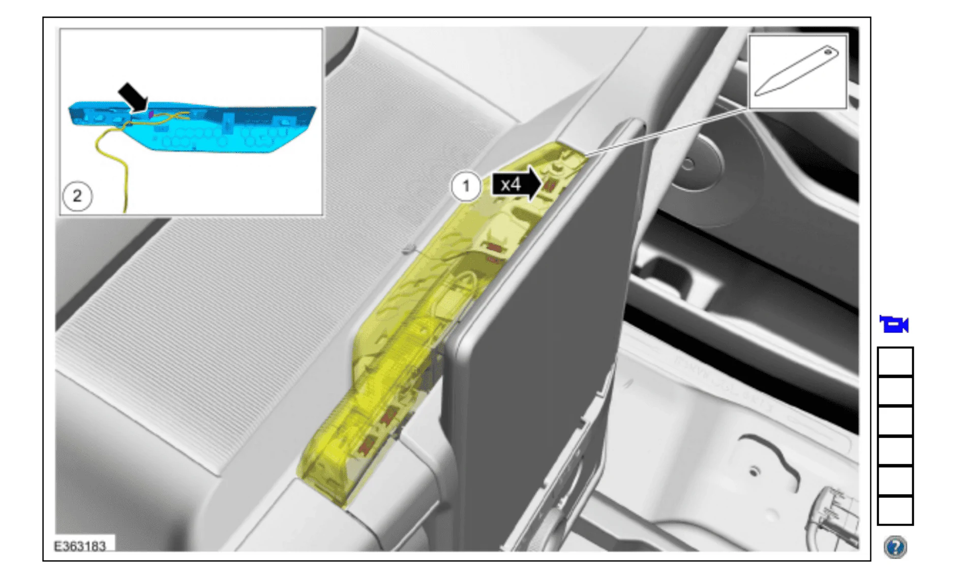

Walk-through and pics now posted - how to get behind / remove trim on 15.5" Lariat screen.

so I was able to install my Naviks. DO NOT go by the Expedition manual (the 15.5 dash looks the same but is not connected by the same bolts/screws. If you try to force it you will badly break things. It's actually a fairly easy install except for reaching some of the top screws.
The nav bypass works fine. FYI, the vehicle STILL knows you are moving and won't allow things like the little games, YouTube, etc. probably best. I have the magic box if I have to allow passengers entertainment while driving,
