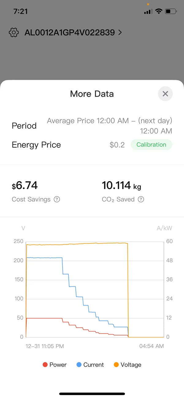

I wanted to post what I am hoping is my final update. The dealership replaced module #2 and I have taken possession of the truck. It successfully charged to 100% and the charge curve appears to be normal. On a level 2 charger, the charge current does not start to ramp down until it is over 90%. My variance between modules is now at 2% as opposed to over 20% when the issue was occurring. My scan tool indicates that the battery is in a state of re-balancing which I think is normal after this type of work? Any tips on how to achieve a balance sooner?

Drive and charge, typically what's meant by time.
Great to hear. L2 charge to 100% and let it sit overnight, should go a long way towards balancing out the remaining 2%
