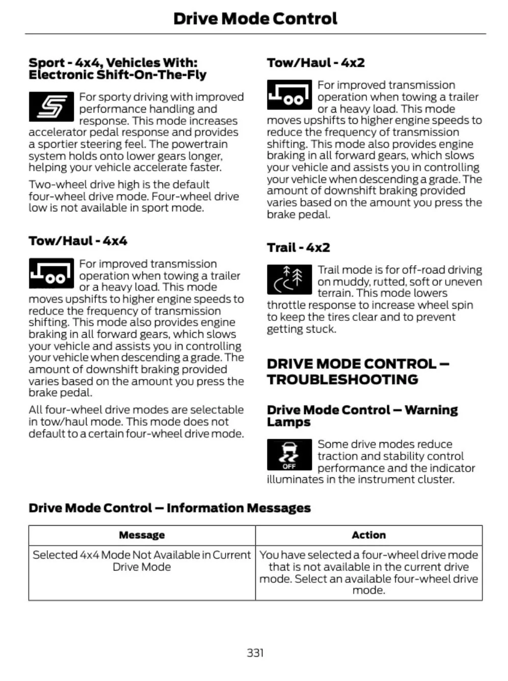

I suspect that the drive by wire throttle pedal could have a different sensitivity. The muscle memory that you developed in normal mode possibly made it feel different, kind of like back in the day when guys would change out their throttle cable bracket and think it gave them extra horsepower. The slippery and winter modes do this in reverse and the Sport mode does it in addition to holding the gears longer. The manual doesn't mention anything about changing throttle sensitivity in Tow/Haul but it's possible that it makes it more sensitive.
Ford F-150 Lightning What changes when Tow/Haul mode is used? 1266A115-315C-42AB-A340-0BDAFB354757
The strange braking feel could be the additional engine braking in Tow/Haul. The transmission on a lot of new vehicles let cars and trucks coast better when you let off the throttle. On some cars I have driven, it almost feels like something is wrong with the brakes as you're slowing down and the compression braking is suddenly absent and you have to press the brake pedal more than your muscle memory anticipated.
