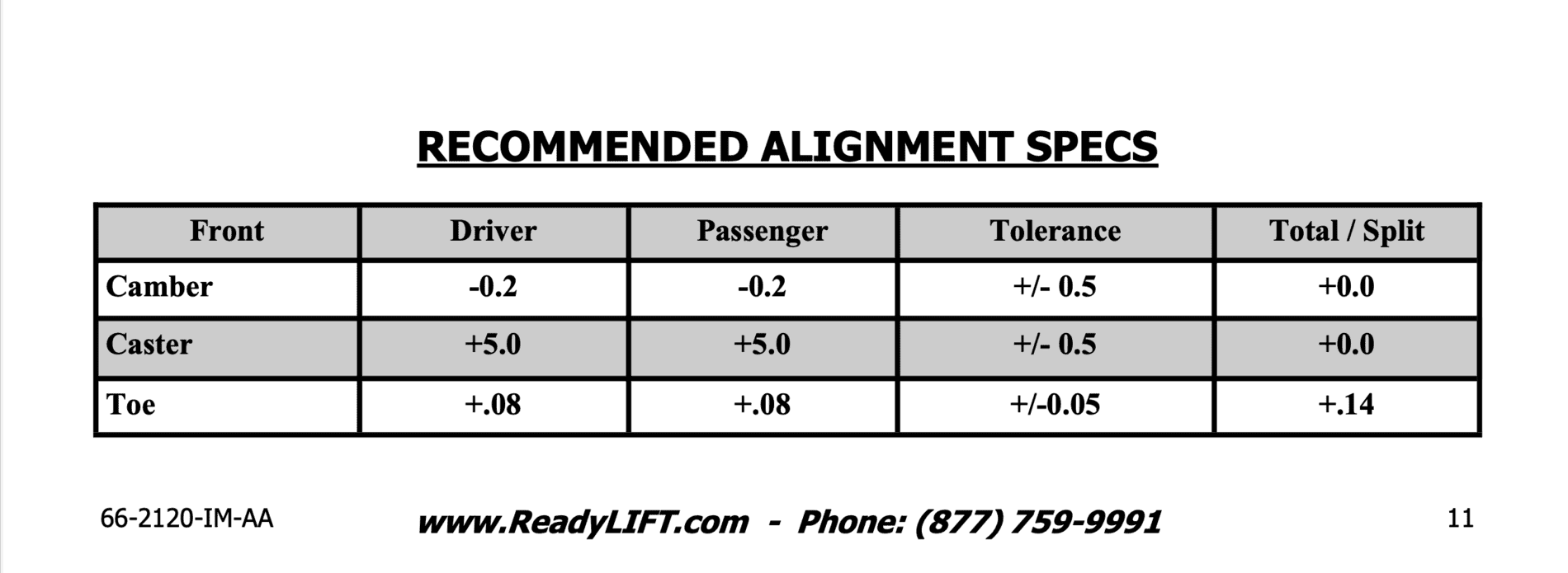

Those that had alignments done to their trucks already, can you post the alignment numbers? I just installed a 2-inch level kit on my truck and wondering if anyone knows what the alignment specs are for the 2021 F150s. Since the 2021s suspension design is very similar to Gen 13 trucks, I wanted to see if there is a difference.
I'll call a Ford dealer tomorrow to see if they can give me any insight. I probably should have done that before taking the truck apart, but that would be no fun.
