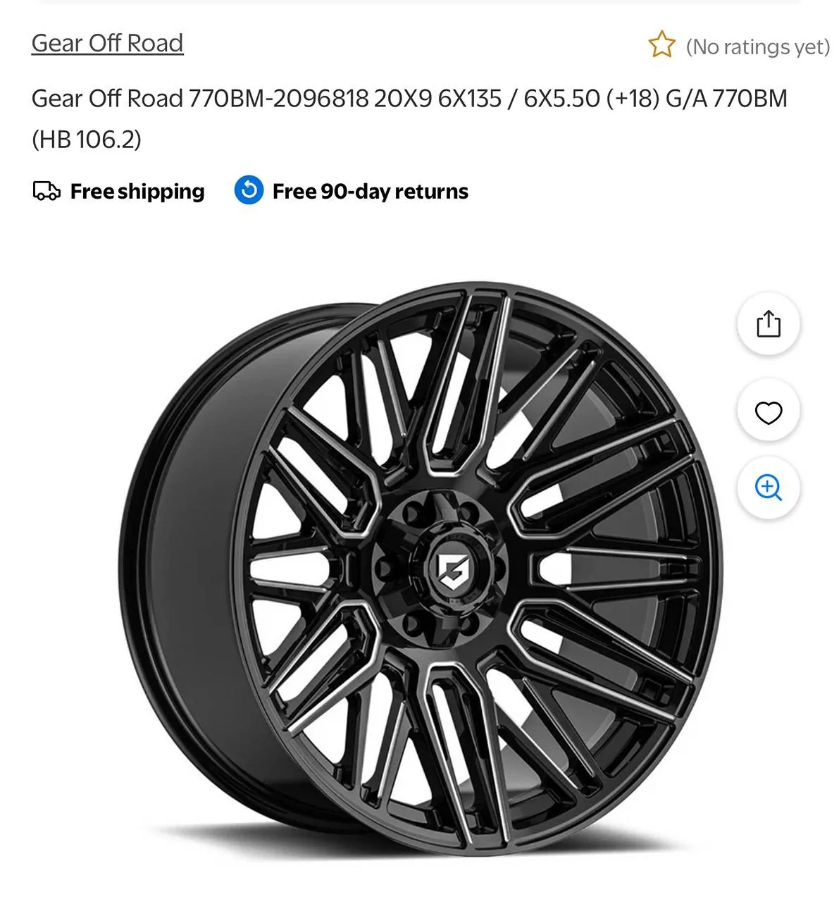

Good afternoon everyone. So I am looking to purchase a set of wheels. They are 20x9 18 offset which is exactly what I am looking for. The bolt pattern in the description says its 6x135 / 6x5.50. So my question is. Will this fit on the truck? I tried to google it but the response I get back from AI or whatever is "6x5.50 will not fit on a ford lightning". I am a little confused by this because it also says its 6x135 which is the lightning bolt pattern. Any input would be great!

6x135 is correct. 18 offset is going to have your wheels outside the fenders, stock is +44. The closer you get to 0 the farther out the poke.

i guess what im asking is mainly about the bolt pattern. It says 6x135 / 6x5.50 so when I add that on the site it says it the fitment isnt correct due to the 6x5.50.

It's the same bolt pattern that Ford has used on the f150 for years.
Just be careful with tpms sensors, there was a frequency change midway through 2024 model year.

So the wheel should fit then.
this is what the wheel description shows
Ford F-150 Lightning Wheel Bolt Pattern 6x135 / 6x5.50 IMG_1299

6x135mm is the typical bolt pattern Ford/Lincoln. 6x5.5(139.7mm) is typical for gmc and Toyota. The two are not the same. If the rim comes in 6x135, you’re golden. Maybe I’m missing something, but the description isn’t totally clear - does it come in both sizes?

I looks like you can order two different sizes. If you go to check out, look for an option for size. Or where it asks for fitment.
