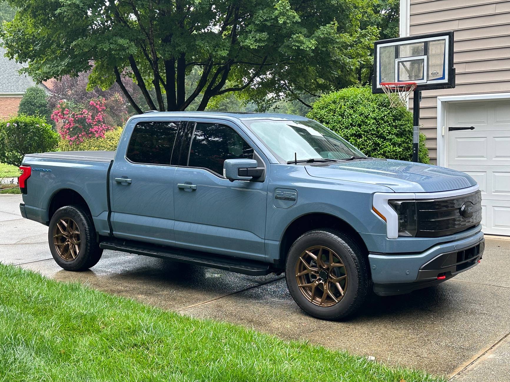

I had the VR601 on with the stock tires and a level kit and they fit well.

I've seen several recommendations for the VenomRex VR601 wheels but I've only seen them on Lightnings that leveled their trucks. I'd like to know if anyone has put these wheels on a stock Lightning. Did they fit without rubbing? I don't really want to level my truck just to make these rims work.
Yes, I had them on my stock truck. Loved them. No adjustments needed, to include leveling
what offset did you get for the wheels? Size/oiffset of your wheels please? ZI am about to place an order....
There's only one offset if they even still make those wheels.
