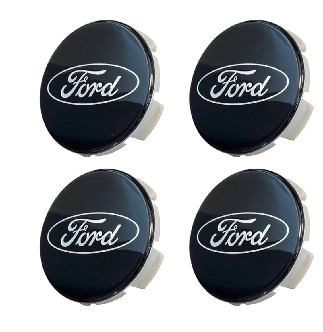

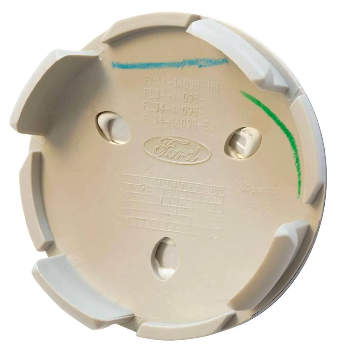

The Ford center caps are snap ins. It is the black metal Ford emblem hot glued to a plastic back plate which snaps into the center hole of most Ford wheels.
The center cap for our wheels is also exactly the same size as the Ford metal badge hot glue to the plastic snap in back plate
So what I did was I took the badges, used a heat gun to soften the glue, pried them apart carefully, and then applied 2-3 layers of 3M double stick tape and adhered them to the VenomRex center cap.
It makes perfect sense when you look at it. Pics below

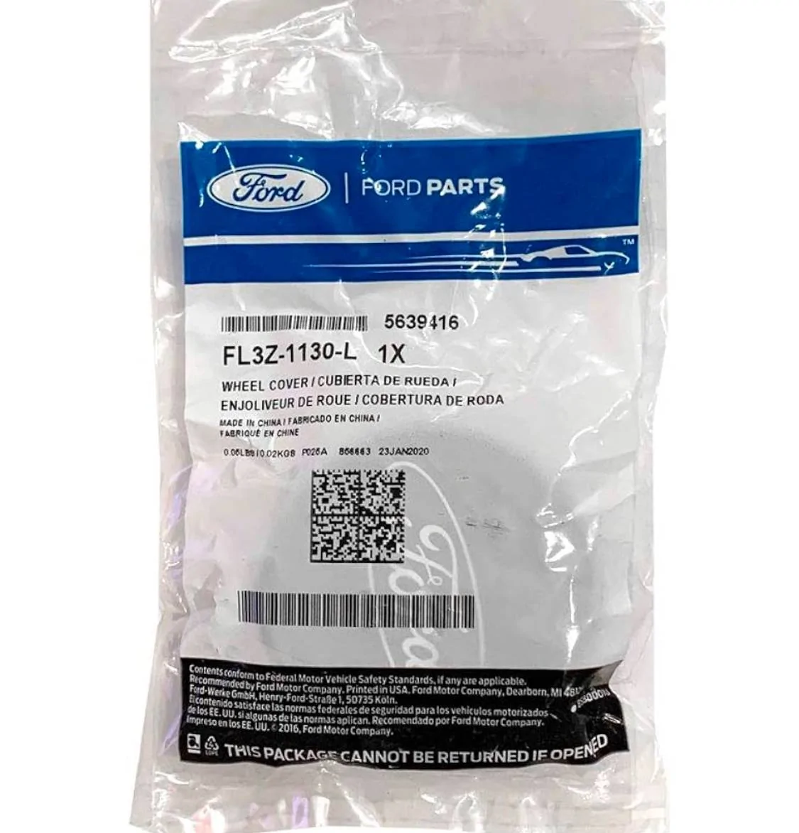

Thanks for your response. I've got the new sensors and just purchase the new Ford hub caps. I'm planning to sell the original wheels, so I'll keep the original sensor and cap on them.
