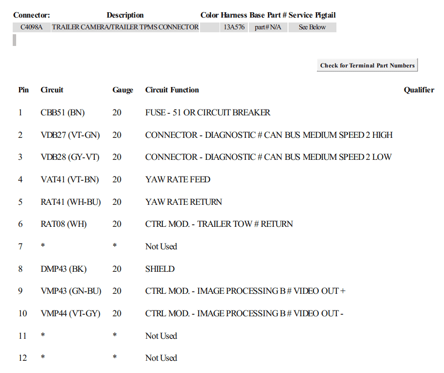

I tried doing some research on yaw rate sensors and I just cannot figure out how this thing can work with only 2 pins. Typically these sensors have a CAN-H and CAN-L for communicating on the CAN bus, plus a power and ground pins. I'm baffled as to how the yaw sensor even works without 4 wires... UNLESS
Here's my new wild theory:
Look at the pinout I showed a few posts back. Pins 4-5 are the only 2 populated. However, every yaw rate sensor seems to need the 2 pin CAN bus. So my new theory is that this yaw sensor just receives power and ground on pins 4-5 and the CAN bus on our trucks is completely wireless. I think the CAN bus is simply a private wireless LAN now, for modules all over the truck.
Now an additional theory (and we'll have to see what the TPMS+Camera option has) is that it also is just a wireless module and somehow includes a passthrough power female socket for the yaw sensor. The TPMS+Camera module may be a repeater that collects the data from the camera then wirelessly transmits it to the truck's Sync, and it only needs power+ground from the socket, and that long ass wire from the camera.

I'm very interested in this also (both trailer cam and trailer tpms), and more than a little concerned about the lack of wiring in that super special connector....
So I have a theory. I searched for everything I could find on those PN (included the A, B, C, D) which have been around longer. And ending up in Super Duty forums, etc for previous years (eg. 2018...).
And even though in those cases it was a different connector, but separate from the 7pin Tow connector, what it seemed to be is there was a fully wired cable with a dust cover plug that terminated up under the bed (you had to drop the spare tire down to access). Then in the accessory kit was a cable to plug there and then come down to the hitch receiver area to plug in the TPMS/Camera cable.
So maybe that is what is happening on the new 2021 F150 with the new Yaw Sensor. You get a higher wire count cable to meet up with a terminated cable under the bed to hook to the back of the connector, or replace the 2 wire cable.?.....??
I do NOT believe it is wireless (why would they have a started usage of a new 12 pin cable connector for interface). And I know you it can not piggy back all of the required interfaces into the 2 pins people are seeing. But also strange some are seeing 4 wires. And also, there was no way to specify in your build that you wanted support for those accessories (except the YAW sensor which is part of the trailering options packages, i.e. Max Tow, etc.)
But, I'm also afraid, especially since there is basically NO information on these new accessory parts (with sub pn code of E and F), that this is a screw up on the Ford designers and then didn't get the in truck cables released correctly to support the full connector. Hope not.

So post script. Anyone who has their 2021 already and is interested in Trailer Cam a/o TPMS want to crawl under their truck and see where that 2 pin cable routes to toward the front of the truck (you may need to drop your spare tire). If you can trace it back to another connector somewhere between the front of the truck and the back, then see if you can get a pic of that connection and whether there are 12 wires on connector coming from the front of the truck....

I'm still going with the wireless bet. Which means the older superduty TPMS/camera part number will not work in our '21 F150s if it relies on wired CAN bus or video pins. There are tons of super cheap wireless CAN bus modules that hop on private 15.4 XBee or Zigbee networks, all the module would need is 5V (or 12V). They can easily put that in the little black box like our yaw sensors.
Re-use of the connector makes sense to me so there isn't a whole new sheath they have to fab, they just populate the wires as needed.
It's the only thing that makes sense to me, way more sense than promising some equipment and then having to re-wire all the trucks already sold with only those power+ground pins wired.

If you watch this guy's install videos, in the superduty there is by default a wiring harness safely tucked away near the trailer plug, above the spare tire. To put his receptacle that has the round 12 pin proprietary connector, he had to attach this dangling harness to the receptacle on the backside as in this vid (). It has way more than 2 wires.
At about 2:20 of this vid you can see his cable. It splits into the TPMS module and the camera module. Each have at least 4 wires to it. So the superduty version DEFINITELY needs all the wires populated.
If ANYONE is able to procure the '21 F150 specific TMPS+Camera we can see if they now only require 2 wires (power/ground) to operate.
If @Drmadeit got a hold of the version for superduty then I think the camera will have no where to send signals as the wires are just floating at the 12-pin round connector. I would love to see what colors the wires are in @Drmadeit's version. I think TPMS needs pins 2-5 and not sure which ones feed to the camera split.
