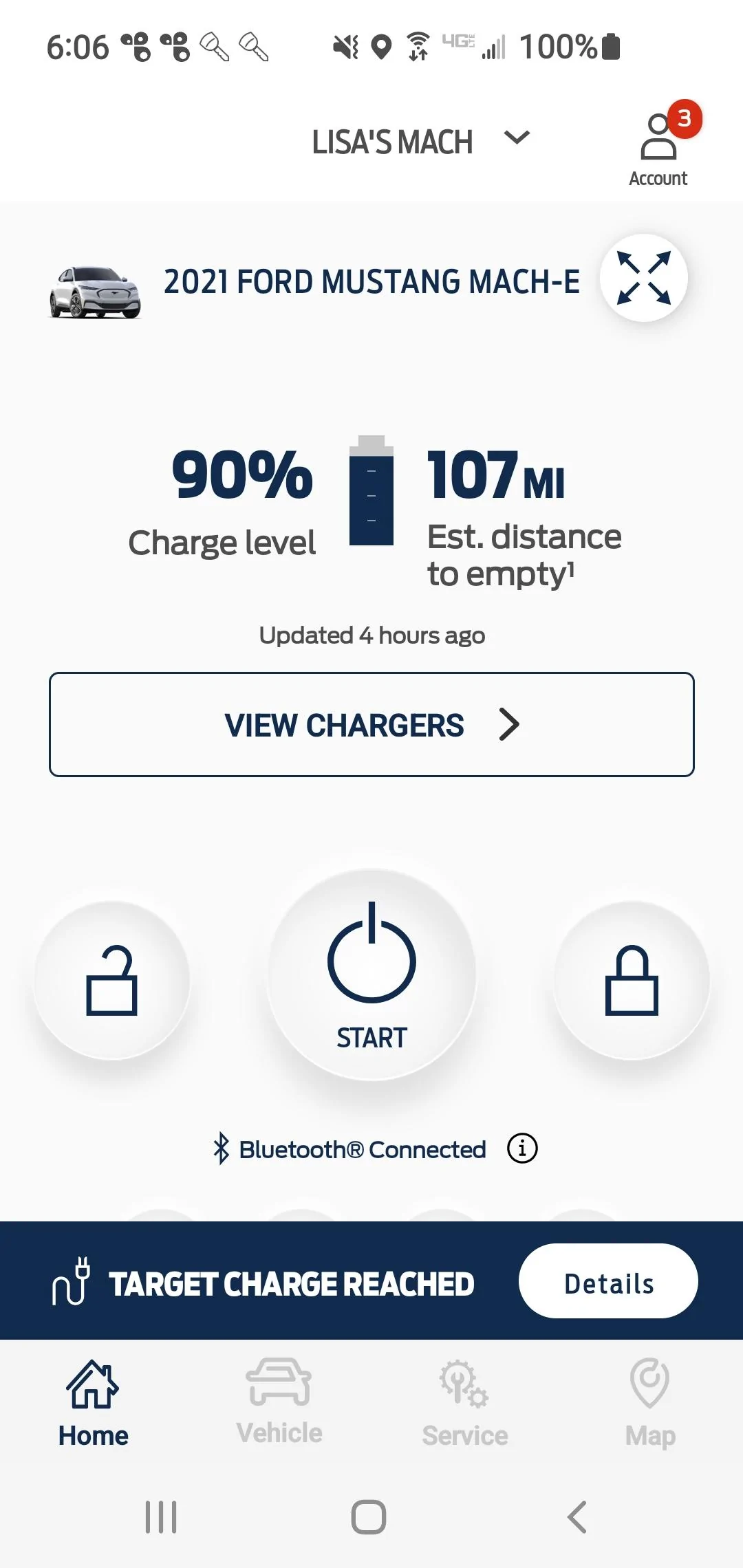

My average daily drive is around 90 miles, so I should be fine. If I feel any anxiety, I'll likely just charge to 90% in winter and 80% all other times. This gets me another 10+ miles. I assume the battery will be able to take on the seasonal bump.
I plan on doing 90% for daily use year round. That is what Ford recommends for the Mach-e (and what we do).
