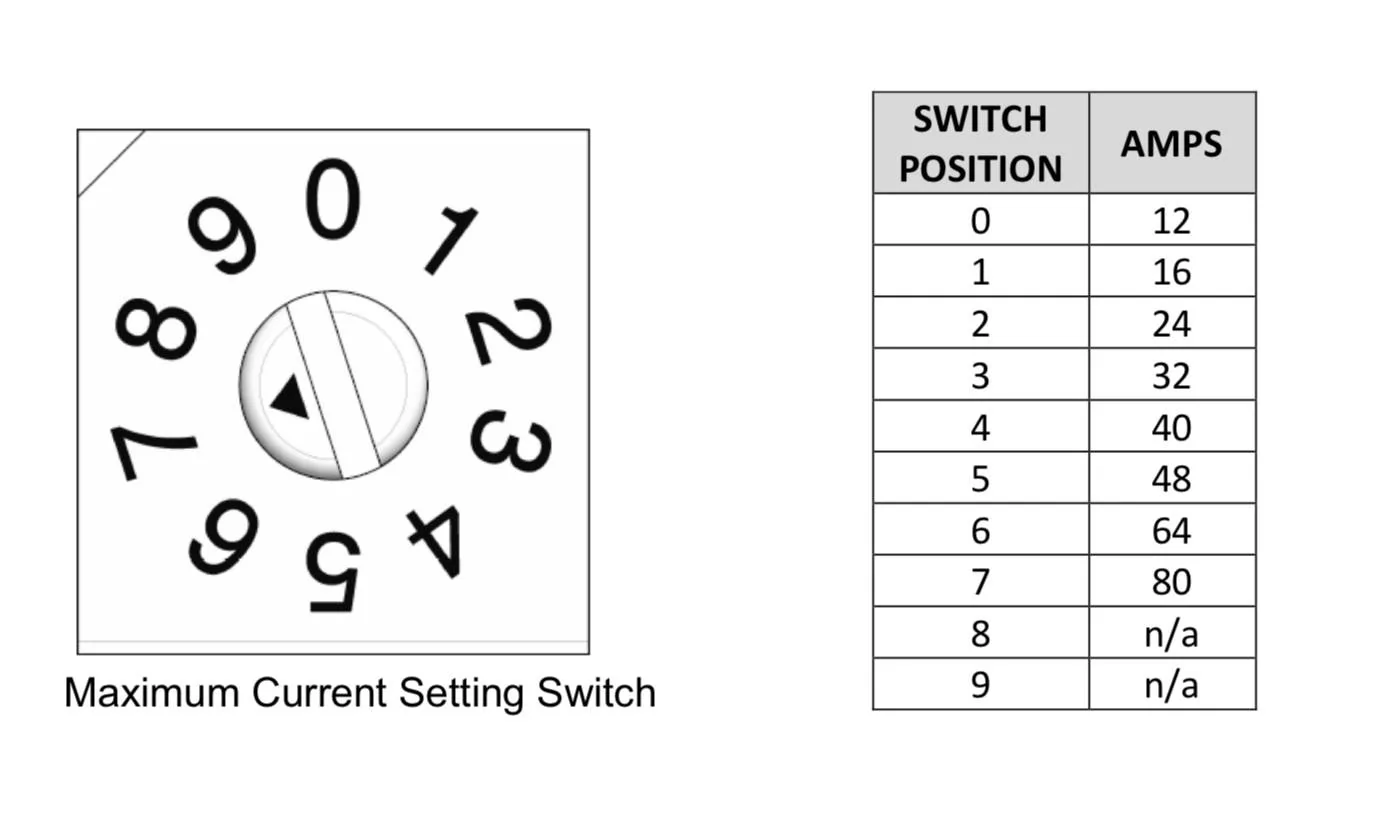

Charge Station Pro can be turned down with the internal switch.
If you already paid for a outlet to be installed and you took the $500 rebate instead of the redd charger and installation then seriously look into the Emporia. It can be plugged into a 50 amp outlet and set to a max 30 amp output via their app if desired.
Here is the setting for the Ford Charge Station Pro to set the output.
Awesome! Thank you my friend.
