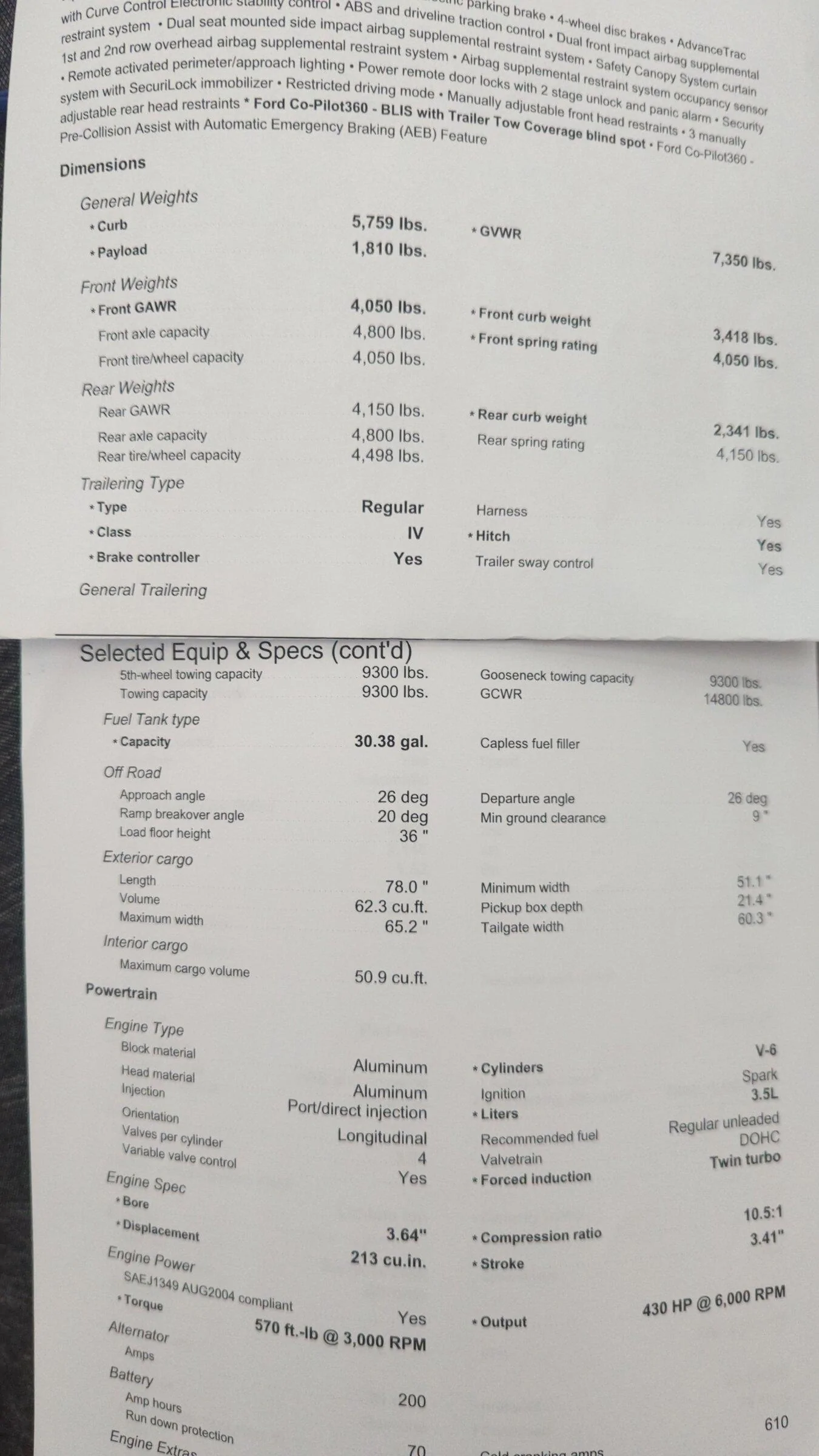

I went in to the dealership to confirm the specs on the truck I built online and to order it. But then when we get to the end of the build the gcwr is only 14800 lbs, compared to the 17000 lbs in all the technical spec docs from ford, and towing capacity is only 9300 lbs, compared to the advertised towing capacity of 11000 lbs. This is still more than the most I would, only once in a while, tow (the most I can add up for a camping weekend is 8000 lbs towed and payload combined), but it is a lot closer than their advertising made me believe. Anyone know what would change the GCWR by this much from advertised? Or what build actually has the advertised weight ratings?
Background information...
Build is a 2022 F-150 SuperCrew PowerBoost 4x4 6.5' box/157" WB with XLT 302a trim plus 360 camera, fold flat storage, bed liner, wheel well liners, skid plates, 40/console/40, chrome package.
Weights from the dealer are (advertised weights in brackets) all in pounds:
GCWR: 14800 (17000)
Towing capacity: 9300 (11000)
GCWR: 7350 (7350)
payload capacity: 1810 (1810)
Curb weight: 5759 (5540, don't know what build this is)
I am having trouble believing the dealership's numbers because the increased curb weight should decrease the payload capacity (right??), And it can't possibly tow more than the gcwr-curb (right?), And changing the curb weight with accessories shouldn't change the GCWR (I'm less sure of this..)
The dealership just answers my questions with more questions, so any insight would be appreciated!!

This is the weight ratings info from the dealer, including GAWR, for the build I listed above

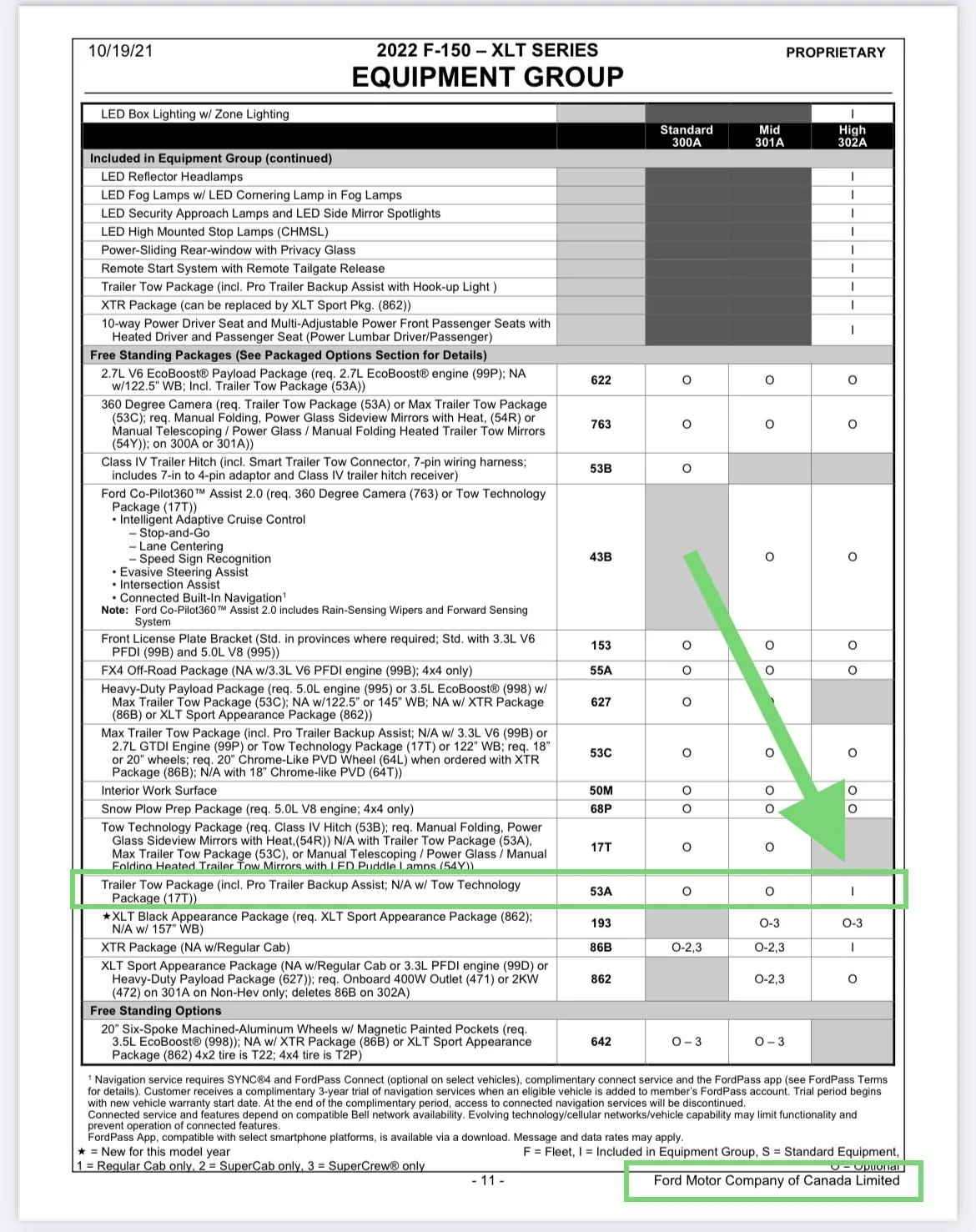

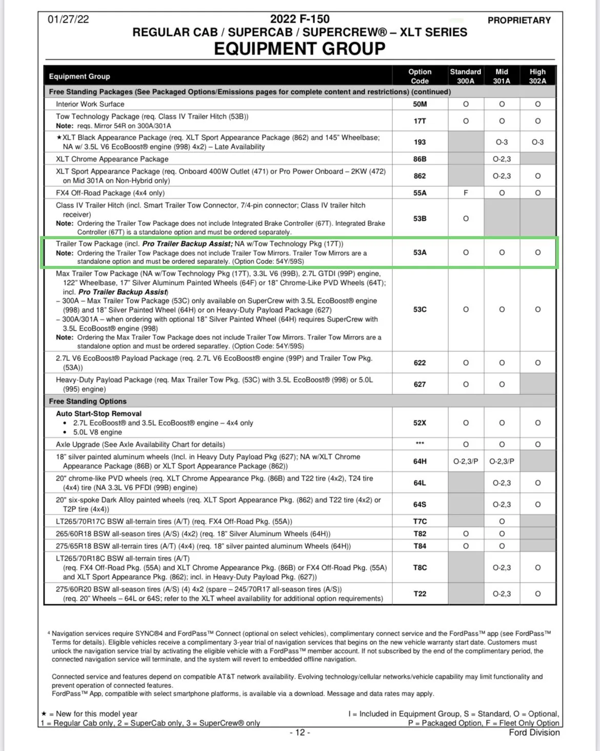

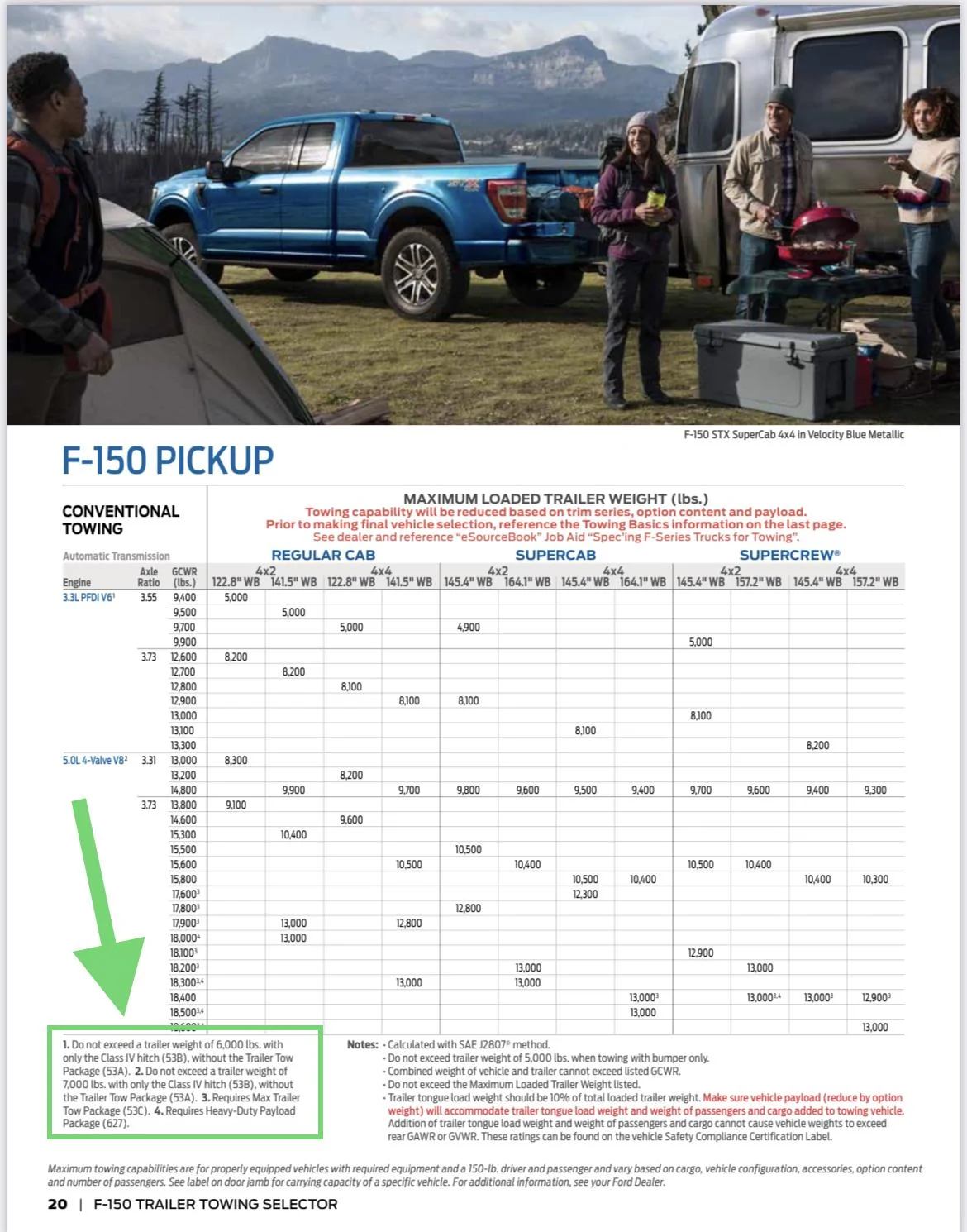

1. 302A does NOT include Trailer Tow package (53A) per 1/27/2022 Order Guide. See below.
2. Per footnote #2 in the 2022 RV & Trailer Tow Guide, F-150s without the trailer tow package are limited to 7K-lbs towing. Multiple discussions on this.
https://www.f150gen14.com/forum/thr...age-towing-options-questions.8629/post-163319
In general yes, tow package is an option, but for whatever reason (Canada, PowerBoost, 4x4, 302a, 157.2wb, some combination...) the trailer tow package is included on this build. I don't know why, but luckily it is. I really wish I could figure out all the contradictions.
Missed that you were ordering a Canadian F-150. Correct: Canadian 302A includes 53A.
Oh! Thanks! That explains it! Where did you find that? Can you share the whole XLT part of the document? I've only been able to find Canada 2021 and US 2022!
