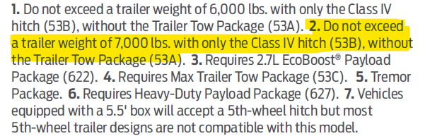

- 2022 RV & Trailer Tow Guide, page 22, states that a PowerBoost F-150 should "not exceed a trailer weight of 7K-lbs with only the Class IV hitch (53B), without the Trailer Tow Package (53A)."
- What's different between 17T and 53A? The F150gen14 jury appears to have concluded it simply boils down to a 36mm solid front stabilizer bar in place of a 36mm hollow front stabilizer bar (per 2021 F-150 eSourceBook). Apparently that increases your max tow capacity from 7k-lbs to 11k-lbs (4WD SCrew) per Ford.
