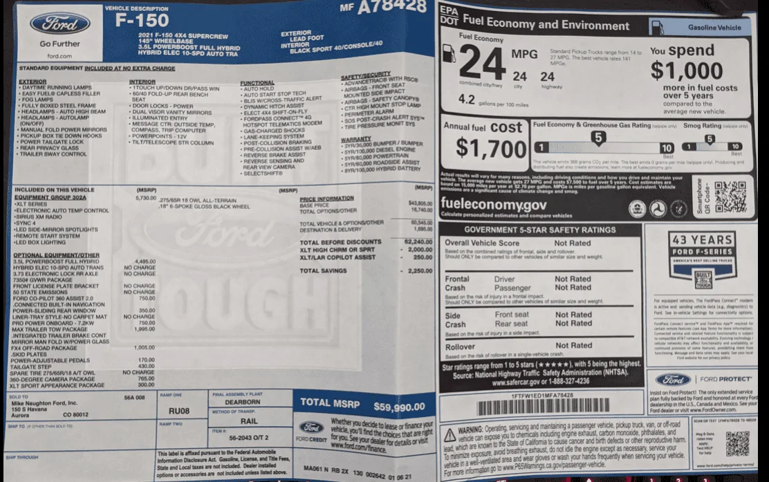

I found two nearly identical (I think?) window stickers except one is Trailer Tow and other is Max Tow. The only difference I see between the two is that the trailer tow one is rapid red and doesn't call out a spare tire.
Using the new VIN calculator...https://fordfleetlive.com/#/VinCalculator
Trailer Tow one has 1609 payload; VIN 1FTFW1ED0MFB00323
Max Tow one has 1581 payload; VIN 1FTFW1ED1MFA78428
Does max tow really eat 28 pounds of payload compared with trailer tow package? Has anyone else found evidence of this? Am I missing something?
Could it be the spare tire?
Attached are the two window stickers.
Here is a link to where I got the max trailer one: https://www.f150forum.com/f82/payload-question-495772/index4/ post 35
I found the trailer tow one on a dealer site.
