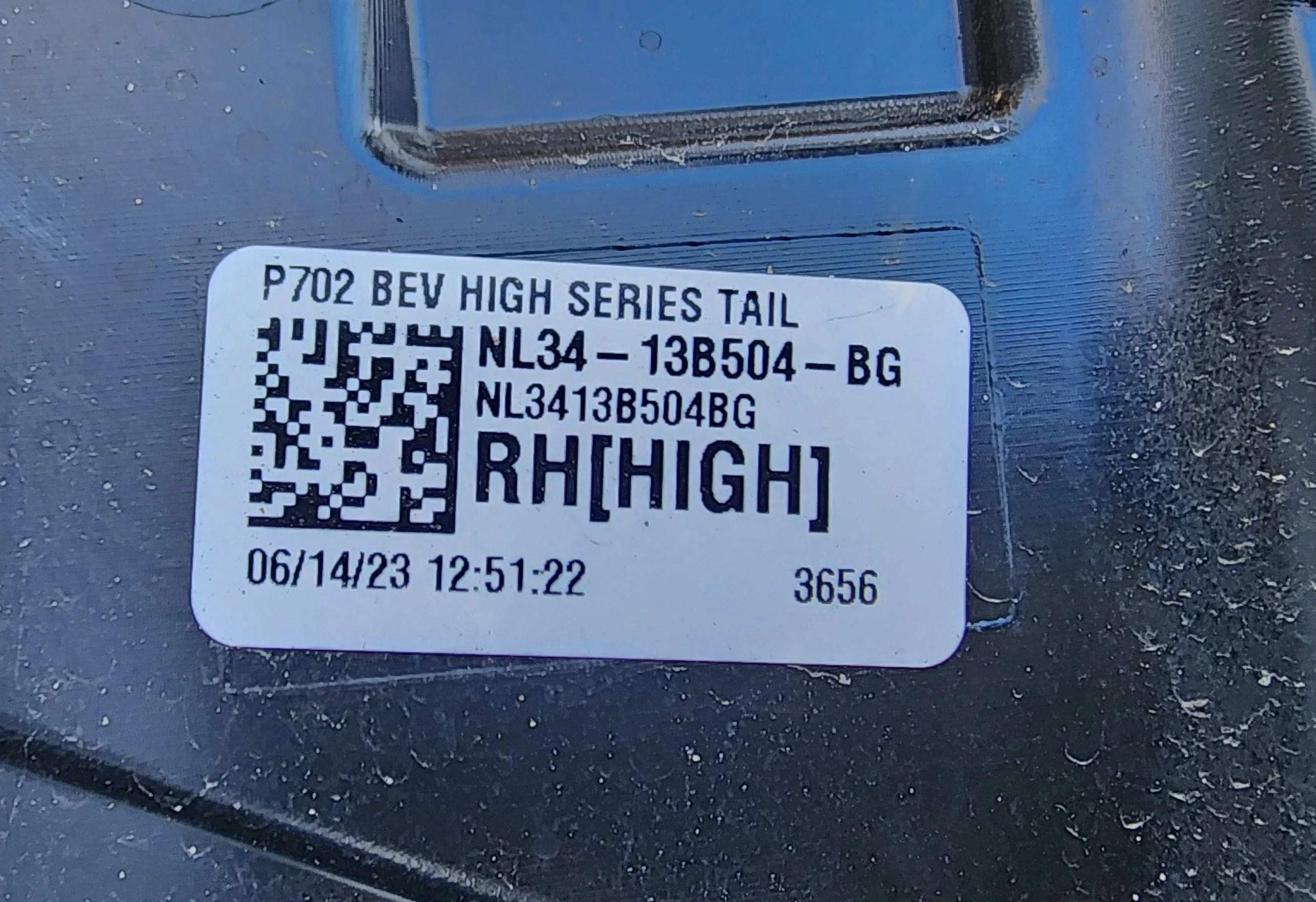

Can't figure how to post a pic from my phone yet, but I bought NL34'-138504-BG.
It's the whole unit with sensor.
The tail light assembly is actually a full LED tail lights with some electronic circuitry inside to provide the regular parking LED light working when the headlights are turned on, but also the brighter LED light used for braking and turn signal indicator. At the bottom of the tail light assembly there is a cavity where the BLIS radar sensor sits. My new Ford tail light part number is: NL3Z-13405-H (no BLIS radar module included) for the driver side tail light.
My original tail light part number was: NL34-13B505-BF.

Yeah, I struggled with matching the part number. Dealers estimate included seperate part numbers for the tail light, sensor and bracket that didn't match up with what anyone was selling. So I pulled out the broken one and matched the part number on mine with the one I bought. Exact match, and I made sure it included the sensor before I bought it.
