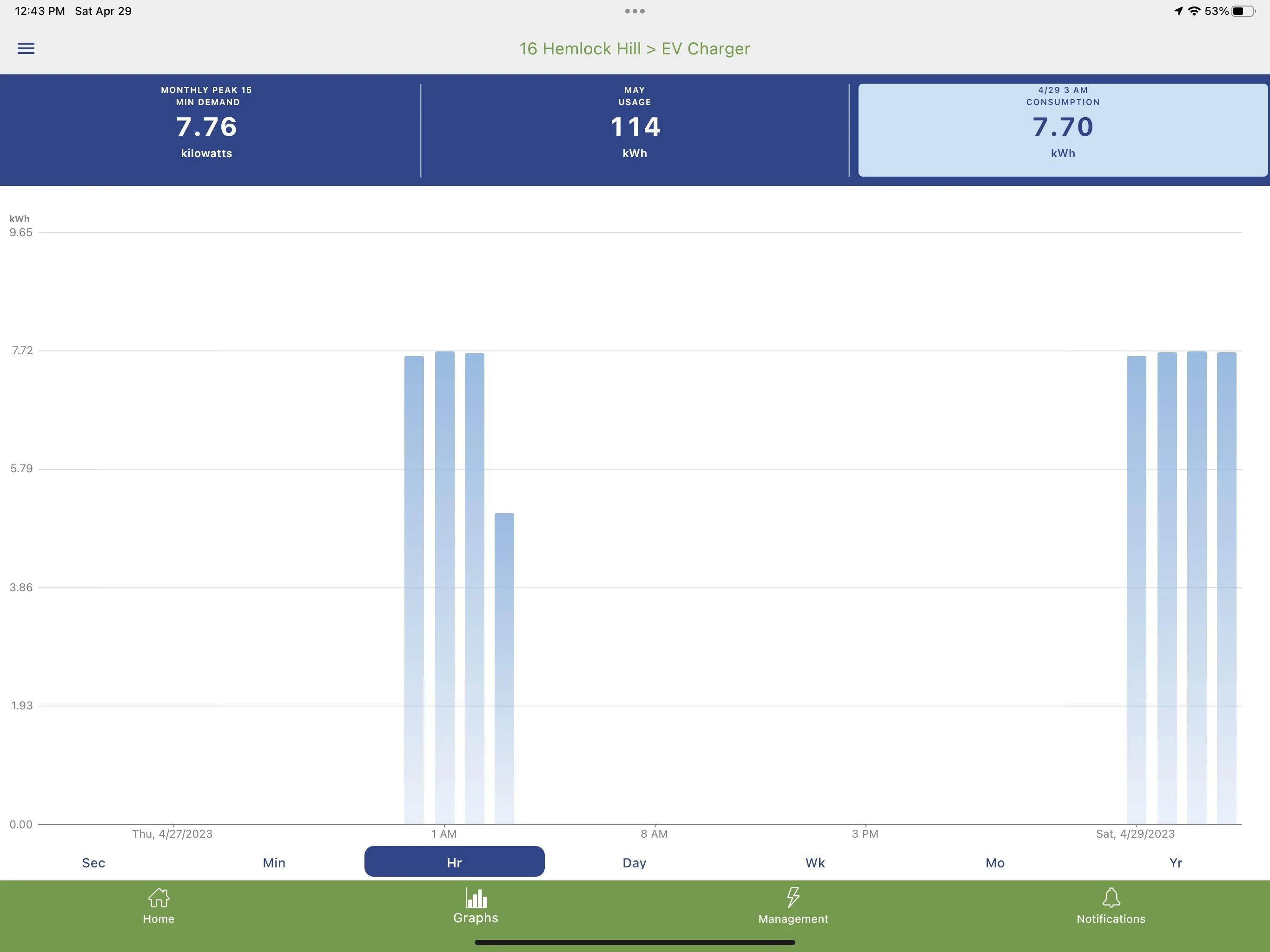

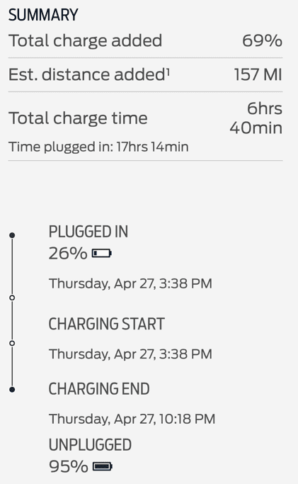

I'm seeing 13.4% less than 48 amps (according to Ford Pass app - 10 kWh). Nothing else drawing on my circuit except a garage refrigerator. I'm going to throw a clamp ammeter in the panel box and compare. I'll also verify the voltage.
Below is a summary of the last charge
Ford F-150 Lightning 2023 Pro Standard Range - CSP 10kWh max 1682792328099
