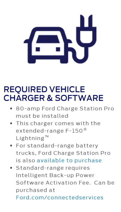

Thinking of getting the standard range package but also considering the HIS. Does anyone know what the software activation fee costs?
Correct. The SR can plug in and charge to the FCSP without any issue. It is software limited from having Intelligent backup. So, even if you bought the HIS system, had SunRun install it, backup power wouldn't work with an SR unless you pay Ford to activate it.I say all the below from a point of confusion, not authority:
I think this is only talking about what it takes for a SR truck to use the FCSP, not that a SR truck can run HIS.
my understanding is that ER is a required option to utilize HIS (which also requires use of the FCSP).
so when this says an SR truck requires activating IBP software, it merely means some portion of the software that functions to allow the SR batter to interact with an 80A charger
That said, anything around HIS seems a sh*tshow, so who knows
im surprised to learn that an SR is comparable with HIS at all - I thought it was ER dependent, as a hardware matter not as a trim / permissions matterbackup power wouldn't work with an SR unless you pay Ford to activate it.
ive reached this conclusion, as even an ER ownerA transfer switch, while less "intelligent" requires no messing around with SunRun or paying Ford more money, so it's likely better option for an SR owner

I wasn't aware of the activation fee. Can't you pay them using 22k fordpass points
I believe you want the transfer switch to have a âswitched neutralâ, not a bonded neutral.I think I read it was $1,000 or $2,000. You're much better off having a transfer switch installed with an NEMA L-30 inlet plug, just like you'd use for a gas powered generator. Just make sure it's a transfer switch with a bonded neutral, a regular interlok kit won't work
