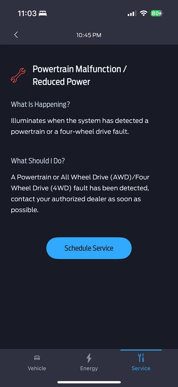

On April 7th, my 2024 F-150 Lightning Lariat displayed a Powertrain Malfunction / Reduced Power message.
The message had appeared 2 or 3 times prior, but always disappeared after a restart. On this morning it appeared as I prepared to leave my first client's location and the truck would not start. Was forced to call a tow truck and have the vehicle towed to the dealership I leased it from. Upon arrival I was told it would likely be at least a week before they could even diagnose it because they only had one Tech who could work on the EVs and he already had 5 trucks in front of me. The dealership will not provide a loaner until they determine it is actually warranty. I rented a vehicle for 3 days until they finally determined it was definitely warranty and provided me with a loaner. They had my vehicle for 8 days before they notified me it was a bad 12v battery, said there was a manufacturing defect in it. They put a new battery in and everything was good.

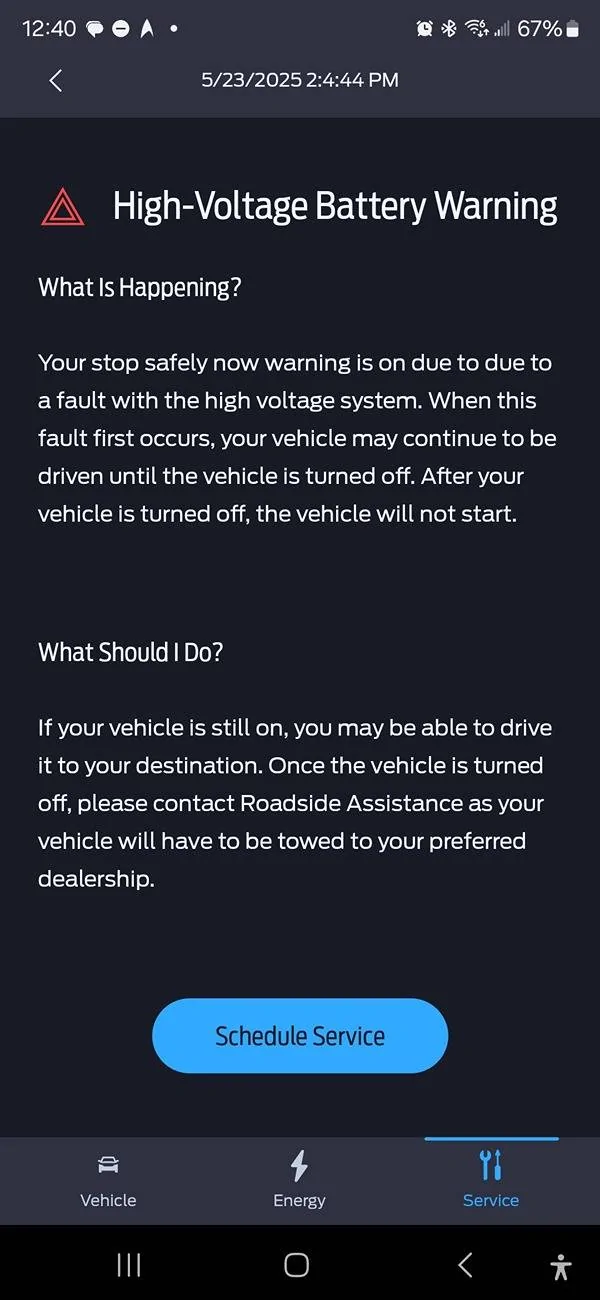

Everything was fine until the morning of May 23rd. While leaving my 2nd Client, the truck started flashing a warning about a High voltage Battery error. pull over immediately. I did a turn off and turn on and found the vehicle would not start. When the message popped up in fordpass it said it could be driven to my destination but would not restart if turned off, would have been good information for the truck to give me before I turned it off. Called for a tow again and had it towed to the dealership.

Wondering if anyone has seen these two errors following one another in a short period of time. From the conversation yesterday, it sounds like the dealer is expecting to have my vehicle for a very long time. This experience has me thinking my next electric will not be a Ford.
