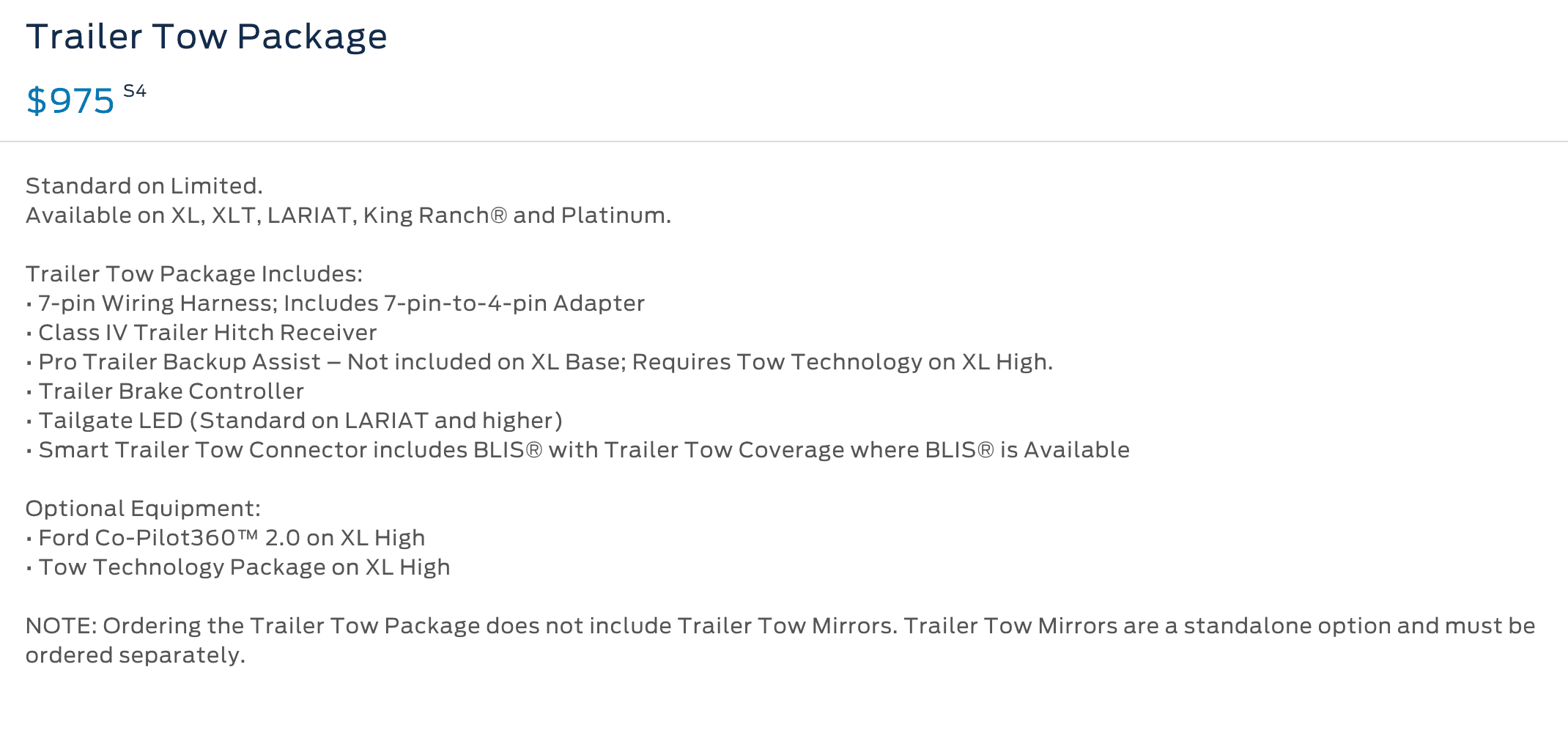

As some of you have learned as well, the brake controller only comes with the factory installed Tow Technology Package.
I made having a brake controller installed a condition of the purchase. My dealer worked with me, called Ford, and researched this thoroughly.
Ford said they have seen issues with the unit sold with the TTP and it would not be recommended for my truck. That was disappointing as the I wanted the sleek in-dash look.​

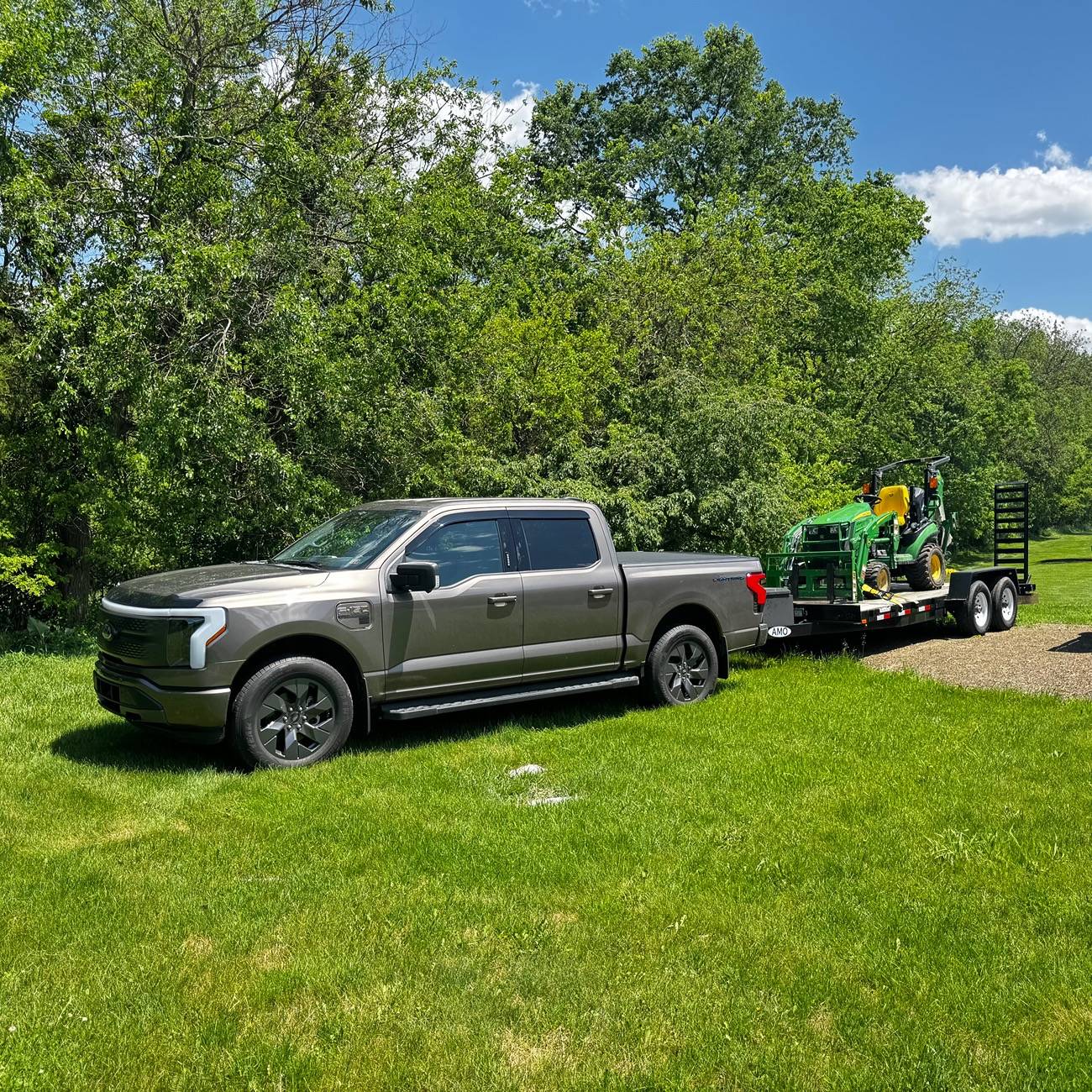

UPDATE: 05/18/2025
Folks, sorry to keep you in suspense!
After having it for 15 months, my buddy literally just returned my equipment trailer to me. I pulled my tractor from my cabin site to home and it did a fine job!
As the picture shows…hauling a JD1025r w/ bucket, FEL w/forks, and about 3/4 tank of fuel; so 3,000lbs.
Ford F-150 Lightning Add on trailer brake controller - possible for Lightning? IMG_6535
