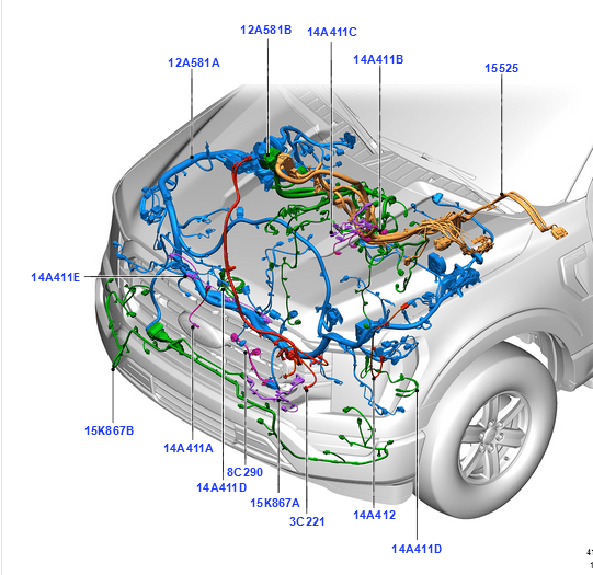

Could someone clarify what parts are actually needed to retrofit this on a 302a? The CCM and steering wheel switch only?

Yes. CCM and Steering wheel switch

I made my own harness. Nothing was prewired in my XL. Its only 4 wires. I higher trim levels may have the wiring there.

when you added the CCM, did you have to replace both 12a581A or just a new 15k867b?
The CCM and switch so far... It's still up in the air if the higher level IPMA is needed or not, and this is just for adaptive cruise right now if that's what you're after. My plan was to play around with mine this weekend getting these added finally, but snow and 30 degree high weather pigeonholed that idea.
Since you have a 302A, I would be really curious if you already have the correct wiring all the way to your bumper harness connector and only need to replace 15K867B like I did on my 501A. Since Jesse has an XL, he had to add the wiring from the IPMA all the way to the CCM. Look back a bit and I posted the schematic for ACC and it include the connectors and pins.
looks like thats going to be my weekend project. Is there any other easier way to access the 15k867B connection without taking off the grill and front bumper?
Nope, but you don't need to take the bumper off, just the top bumper valance plastic piece along with the grill to access that connection, only takes 10 minutes if that, it's really simple. But you do want to take the bumper off to swap the harness if that's the case for you.

Update. Nice enough day to plug my new CCM in finally and see what happens, got it plugged in and fired up Forscan and boom! CCM showed up just like it should finally, so my other one was toast. Got the PMI done on it and DTC went away for that. I need to take the bumper off again to get it in their permanently with the new bracket when I do my headlight swap along with fix some other things, so won't be able to keep playing around with it until then, but at least making progress again!
