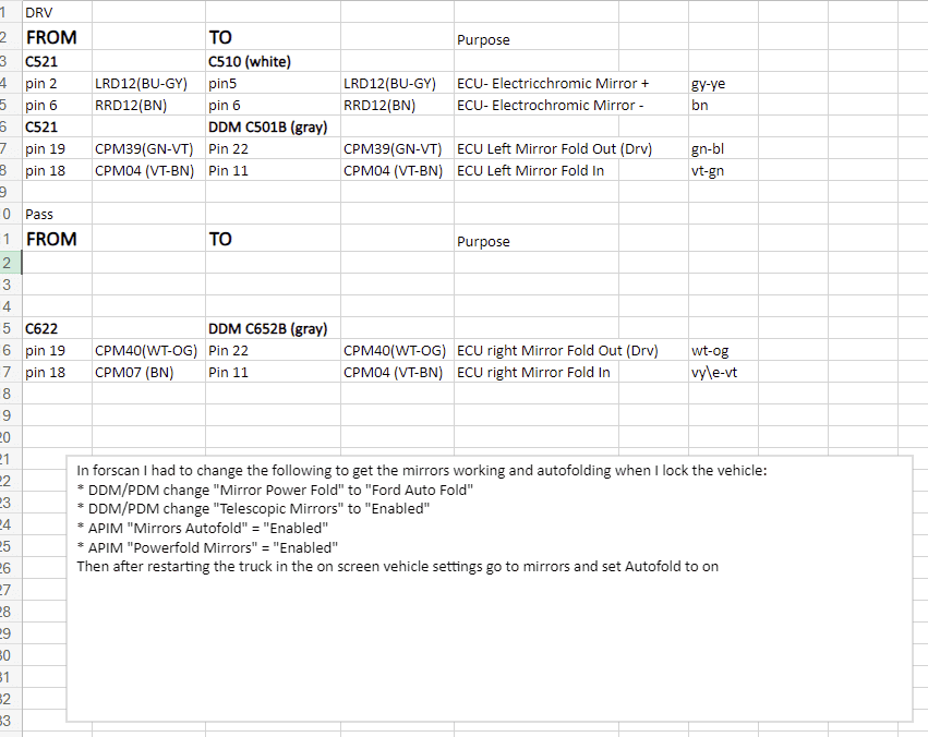

it will depend on your door harness, but really simple.
I had already upgraded my door harnesses for the remote entry (on a pro with tow tech) to the i believe XLT version of keyless entry (not lariat) so i was quite close
Ford F-150 Lightning Adding power mirrors to XLT 1712158994230-cb
but you need the power fold mirrors the door control switch, and or potentially the wires if needed.
I have some video when doing mine from awhile ago ill see if I can dig up. bright ideas to be helpful but much more annoying to edit and publish. I only had to pull wire from the door connector for the electrochromic mirror. the others are for the DDM/PDM to the top plug super simple. I can probably re-lookup the pins i used if you want to do it cheaper than BGG designs
