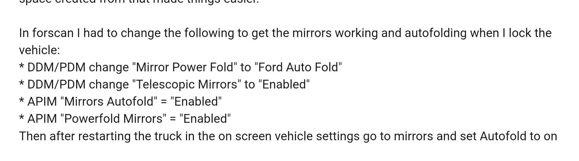

Tries to go through the thread, I came up with the picture below but that doesn't look like it's all encompassing. I don't see the usual numbers and xxx
You can either make those changes in the non AS BUILT modules by searching for the functions, or you can look these up in livinitup's master excel file to find the AS BUILT changes

The forscan stuff is all quite easy and straight forward, HOWEVER, I highly recommend you read through the tutorial which has a link in this thread:
https://www.f150gen14.com/forum/threads/2021-f-150-forscan-list-database-spreadsheet.1578/
It is easy enough to fumble around and figure things out, but bricking your truck is not the same a bricking your phone or your computer. So I would err on the side of caution, read the tutorials, back up everything every time you make a change. Just in case...

If you are using the wiring harness from Boosted Grey Goose, email them after you receive your harness and they will send the instructions with installation plus the Forscan changes needed. They do not say they are for any specific model F150, so checking the spreadsheet to confirm would be smart. If you need the instructions PM me and I can share them assuming that does not violate any forum rules.
I agree with derelict that multiple changes are needed to enable the folding option. one that I listed is probably not enough.
