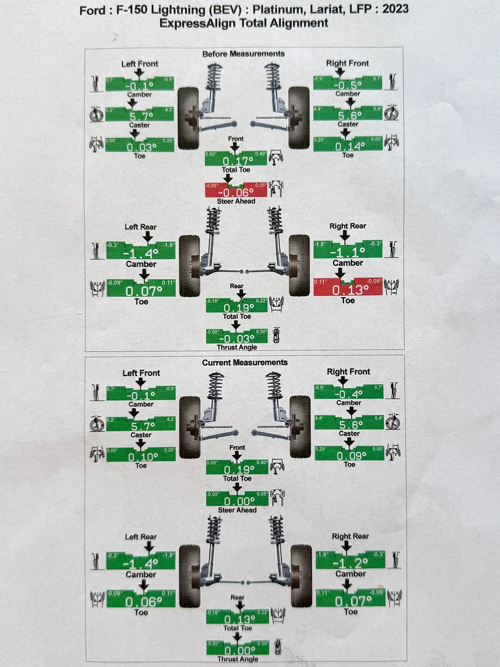

I just had my alignment done at Ford to attempt to correct tire wear and shaking at high speeds issues. My front tires were only wearing on the outside, which I read on the forum was likely a toe problem.
It doesn’t appear those values have changed much after alignment. Am I missing something? Should I ask them to correct anything?

How many miles?
What size/brand tires?
What psi do you run them?
Do you have any suspension mods?
How "spirited" is your driving?

How many miles?
44,000 miles
I switched from the Grabbers to Michelin Defender LTX 275/50/22 XL
42 psi
No mods
My driving is 90% highway at 85 mph. I’m pretty jumpy with the other 10%.

As a data point...2022 Platinum.
I've run 20" Lariat wheels and stock Hankook A/T tires about 15,000 miles, mostly in colder months. They have worn badly on the outside.
I've run stock 22" Platinum wheels and General Grabber tires about 20,000 miles, mostly in warmer months. They have worn evenly and have a lot of life left.
I don't hesitate to accelerate quickly in a straight line but take corners and brake like I'm driving a 7,000lb truck... because that's what it is.

I understand it that positive camber or toe in will affect outer tire wear.
Toe out or negative camber will impact inner tire wear
