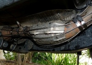

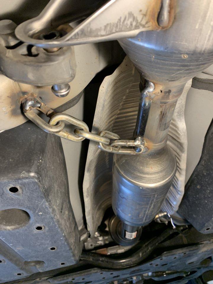

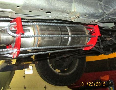

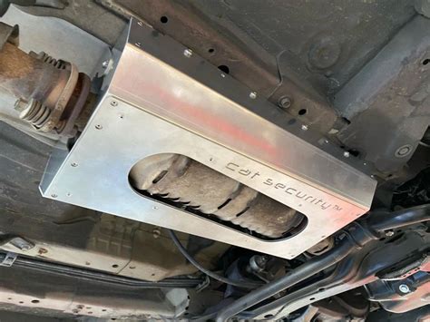

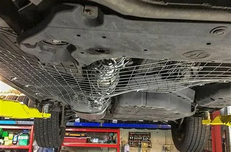

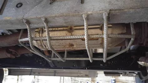

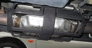

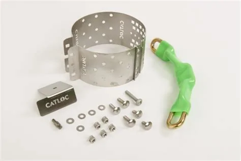

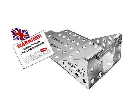

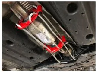

A bunch of cats have been reported stolen on Nextdoor in my neighborhood as well. So I decided to look into it.
Most are using cordless Sawzalls but some are using grinders with cut-off wheels and still others, pipe cutters.
There's several concepts, one is to cage the so it takes longer, others wrap them in cable or clamps with cable or chain. The latter methods are taking advantage of the hope that the thief won't be carrying a bolt cutter to cut the chain or cable off, since there's a big challenge in cutting a moving chain or cable and if something like a wire ribbon is used, it can even foul the blade and jam it.
With a grinder, the best bet is to limit access and make it so the cat can't be removed without destroying it, or use aluminum which can load up most cut-off wheels and make them unable to cut.
There are also aftermarket transmission skid plates that cover where the catalytic converters are. I think one of those at the least will put you ahead of your neighbors, since it's really just about inconveniencing the thieves at this point.
Here are some pictures that I found looking around:

Some of those are looking kind of Mad Max, lol. Subtract 40 lbs from available payload.

some of those make me wonder about heat dissipation, those cats get really hot and need to shed the heat off.
