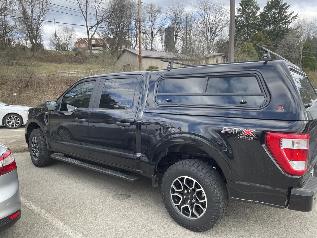

New Leer cap install and I found leaks a week later. Others here ever have similar issue?
My leaks seem to be primarily on windoor latches and removable front window....water will pool on front edge of cap and typically drip off of corners. Parked outdoors in rain and not caused by auto car wash.

Leer 100XR. Yes. Seems like the removable front window and the drivers side slider is leaking. Not much though and hopefully not going to be an issue. My removable window squeaks like crazy over rough terrain. I had to place weather stripping in the frame to stabilize it. The frame looks like a 5 year old built it.
I also noticed some paint issues, drips and orange peel. I had a Leer on the old rig and it was 100% solid, no issues for 13 years except rear window lifts were replaced. This Leer seems like their standards have dropped.
Yes, the removable front window seems to have sealing problems.
I visited the cap dealer yesterday and they found a pinhole in the windoor and made adjustments to the seal on the front window since it was barely touching around the frame. Leaks were especially noticeable when parked downhill.
