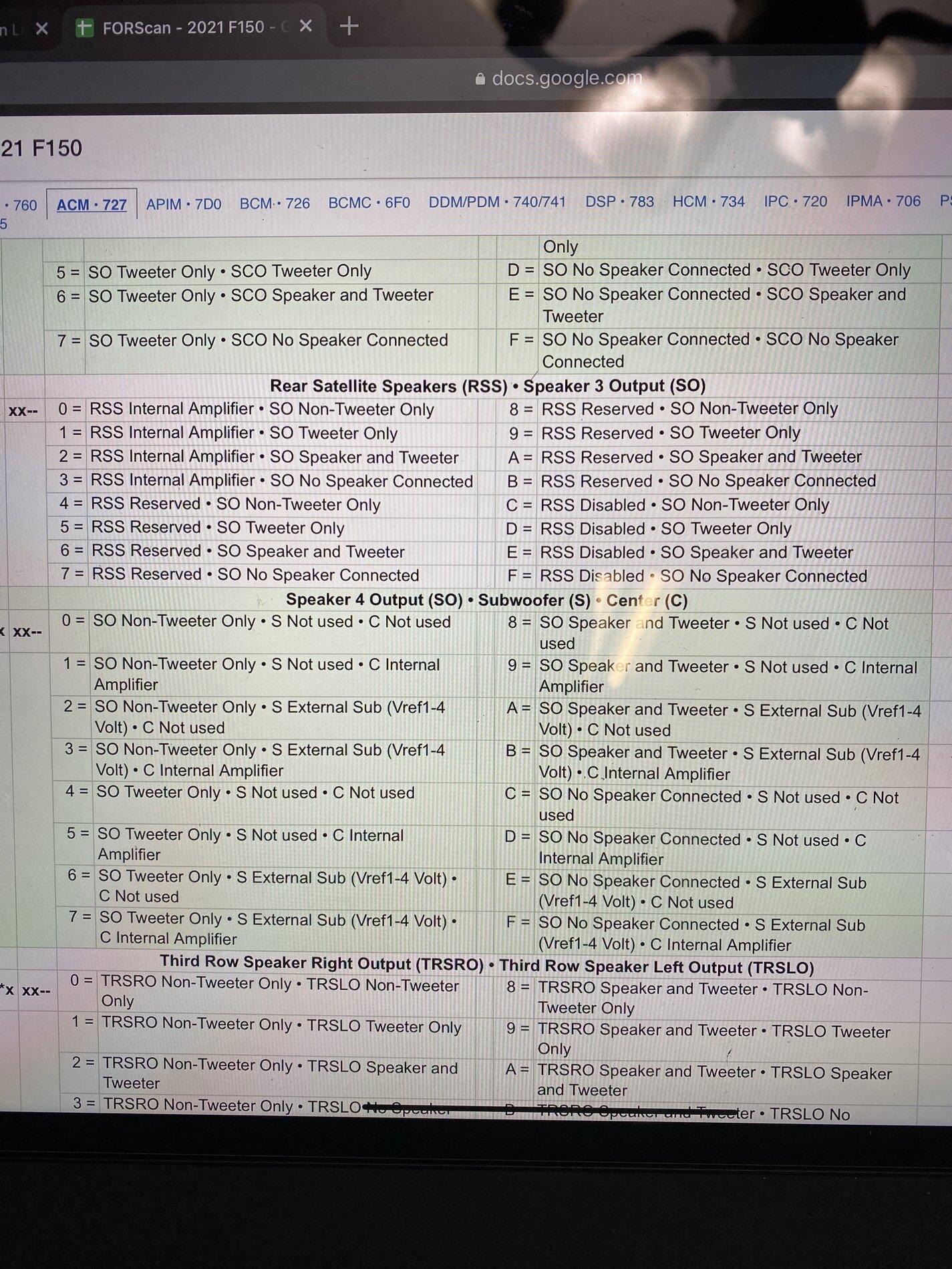

This part of forscan allows you to change the output from the b&o dsp. You can make the sub output a signal out instea of a speaker out. The difference is the voltage remains constant and doesnt roll off when distortion is detected.
can you please explain how to do it and what you used. I tried doing it and it keeps telling me incorrect sum used or something like that
