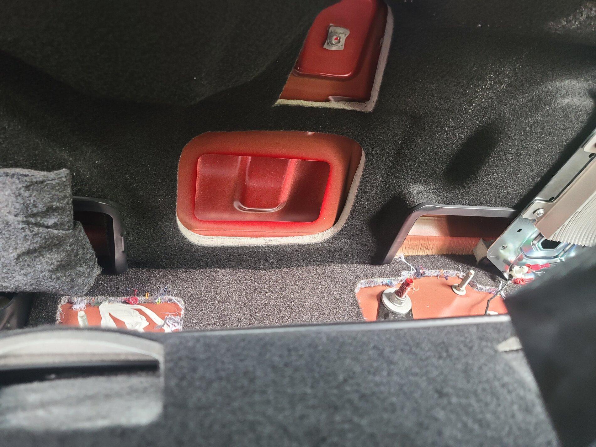

I'm definitely upgrading the sub, ran a 4ga power and ground already.
Found that when you take the factory sub out there is a gaping hole in the cab. I used this to run the 12v on the top of the frame to the battery, easiest power cable install I have done on an F150.
Getting a friend to 3D print me a plug for the hole and adding a grommet for the wire.
