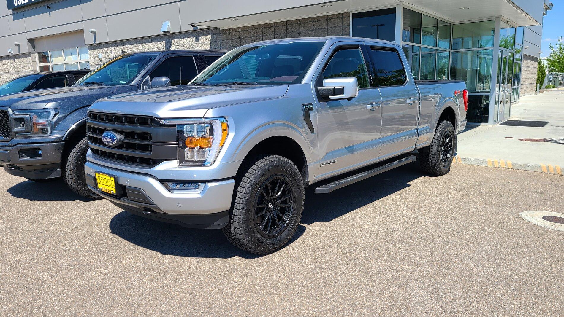

So I have a 2021 Powerboost I've 34" tires with 20" fuels and ofcourse I have to level it! I love the truck but im averging like 15.5 mpg?! Also it's been a bit of a headache fordpass and android auto don't work and every time I open the door I can hear a pop coming from the speakers and same once you start up the truck!! I've already taken it to my service department and they did the Field action service 21b33 but it did nothing still can't use fordpass and the popping is still there... anyone else have this issue? And curious on what everyone is getting on their mpgs with similar setup?
