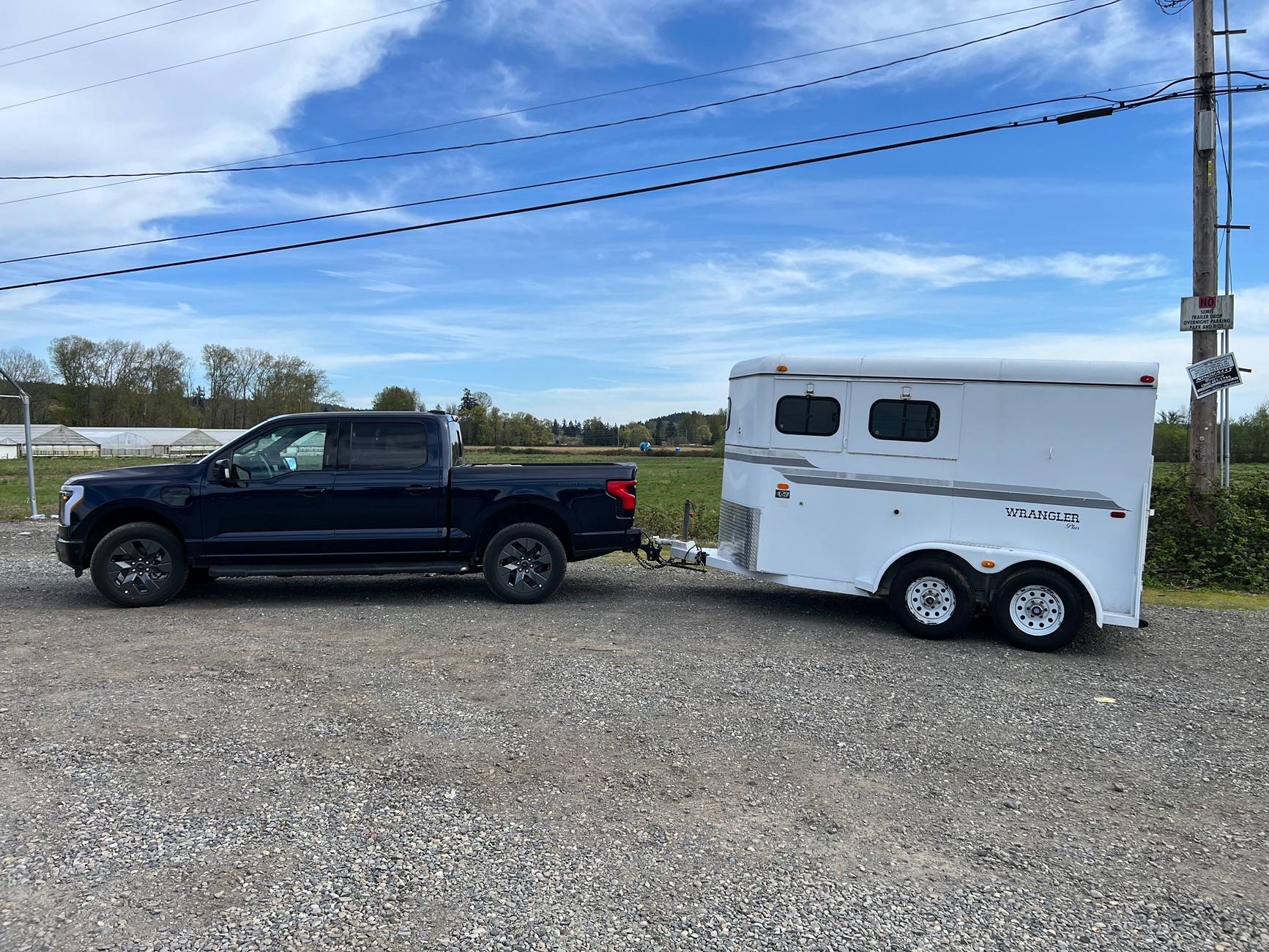

I tow a standard 2H trailer. I get about 1.2 miles/kWh. I am using a WD hitch and I have the max tow package. With this setup, with the ER battery, I can get about 160 miles. Very easy to tow with, and with all the tech, I can hitch up by myself and for a novice trailer, I can easily backup too.
Good to hear. I'm looking at a standard 2H for a comparable price and I'm leaning that way as it would get me a better tack/dressing room. Plus one of my horses is a bit nervous and would probably need some training for a straight load. Thanks for sharing your efficiency numbers with it. Most of my travels would be on smaller two-lane roads, which have been much better efficiency wise than just hauling on the freeway.
