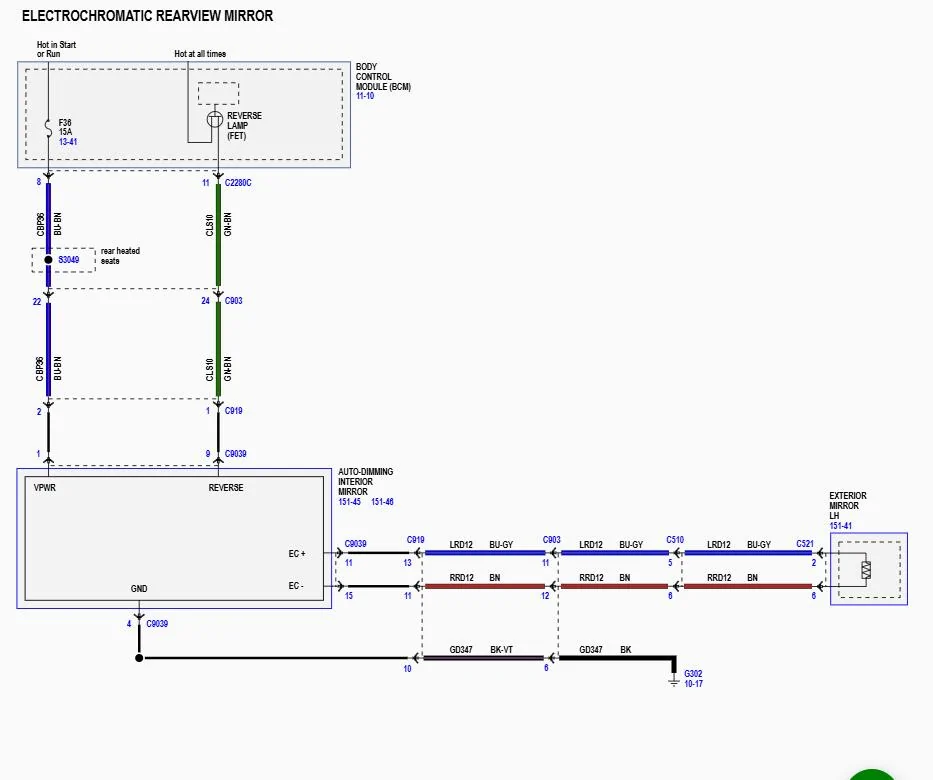

I added power folding mirrors to my 24 Flash. The power Fold automatically have auto dim. The Flash has the dim rear view mirror. So When I was adding the power fold I was hoping to not have to run the wiring all the way to the center mirror because it is what controls the auto dim for driver mirror. Lucky enough the wiring is already at the door connector(C510) So I only had to run from the driver mirror connector to C510. Its two wires.
Edit.. To add the wiring diagram. If you have the auto dim Center mirror you can add the auto dim side mirror functionality fairly easily. Add the two wires from c510 to c521 and you will be all set

The wiring is not in the base mirror for auto dim so you would have to figure out the wiring aspect. Im sure its possible, but not sure the difficulty
