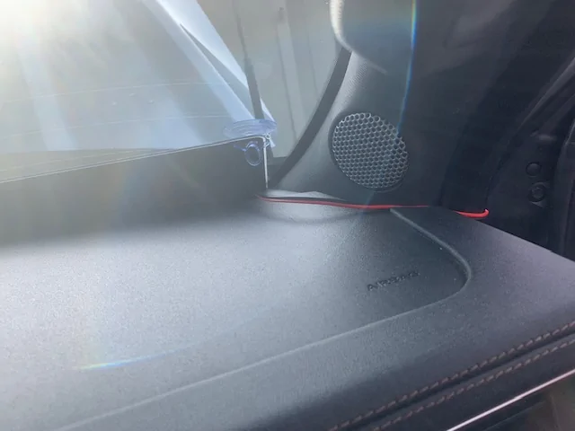

The panel comes with a long cable, which is tucked along the door and under the hood. There are quick disconnects from the cable to the battery so that the panel can be unplugged from the battery if needed.
Anywhere we can see more details on this? Search failing me

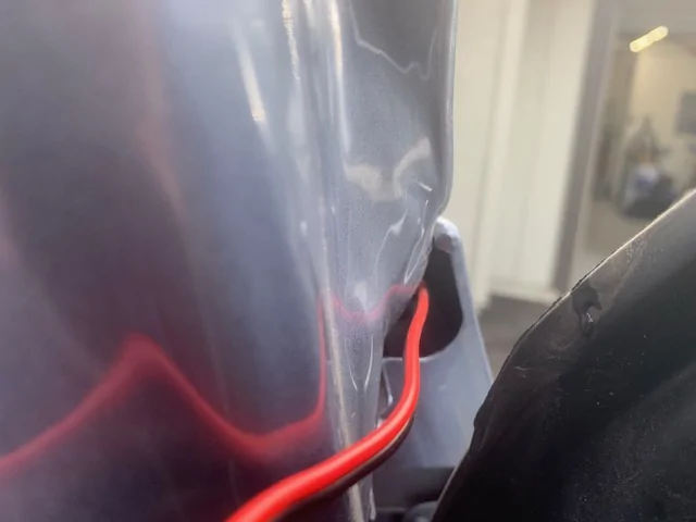

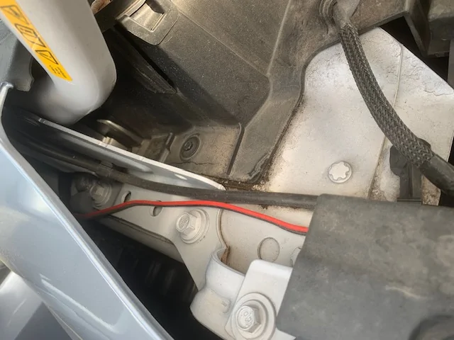

Follow the red and black wires through the pictures:
Ford F-150 Lightning Battery Maintainer Usage IMG_1099
Ford F-150 Lightning Battery Maintainer Usage IMG_1100
Ford F-150 Lightning Battery Maintainer Usage IMG_1101
Ford F-150 Lightning Battery Maintainer Usage IMG_1102
Ford F-150 Lightning Battery Maintainer Usage IMG_1103
- back of solar panel to the passenger side door
- door jamb to tiny hole in right front fender
- tiny hole in fender to inside of frunk
- inside of frunk to underside of frunk shroud
- inside of shroud dives into 12v battery area
And from there to the 12v battery, which I can't take a picture of because the my frunk is full of junk :)
