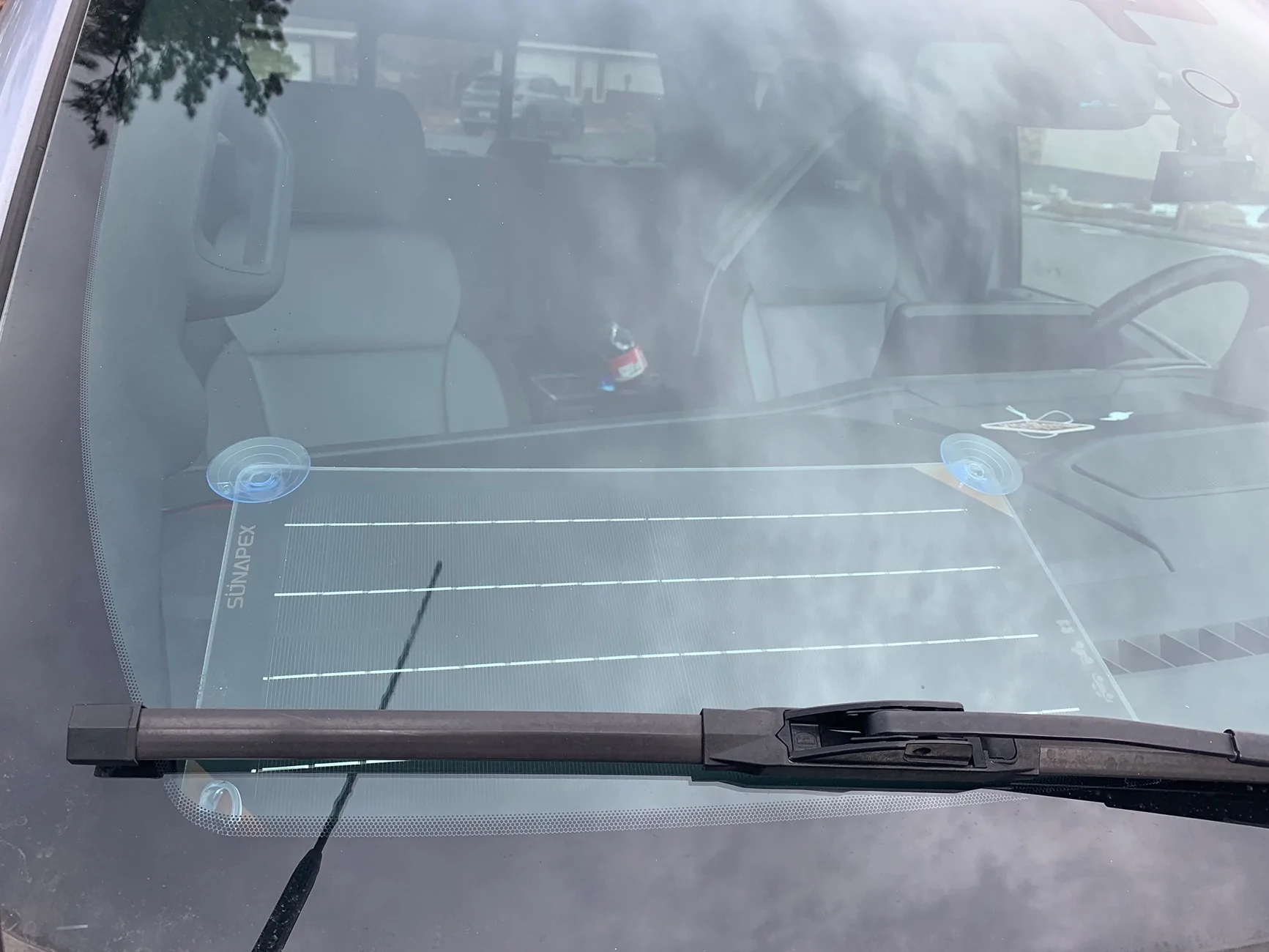

I found I did not drive the truck as often as I thought I would, especially in winter - it sits outside, so I added a Sunapex 30W solar trickle charger and mounted it low on the passenger side of the windshield on the inside, so it does not interfere with the airbag. Even on cloudy days it keeps the battery happy.
How is it wired to the 12v battery?
Some of those use the vehicle accessory/cigarette lighter outlet, but Ford specifically says not to do that, and besides that it disconnects/de-powers after a period of time (30min?).

The panel comes with a long cable, which is tucked along the door and under the hood. There are quick disconnects from the cable to the battery so that the panel can be unplugged from the battery if needed.
That's good...I used to have one in my 2001 Ranger that would plug into the outlet and did a good job keeping it maintained.
