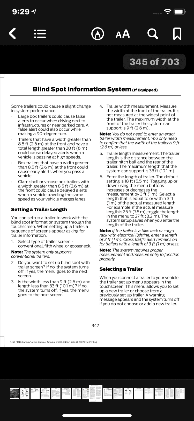

This is from the manual. Did you input the trailer length?
I did not do this procedure, thinking that the new "setup with the sensor" thing took care of the basics. I may just have to do so, and perhaps this will solve the problem. I'm assuming this procedure works in combination with the trailer sensor calibrations, and will not screw things up?
