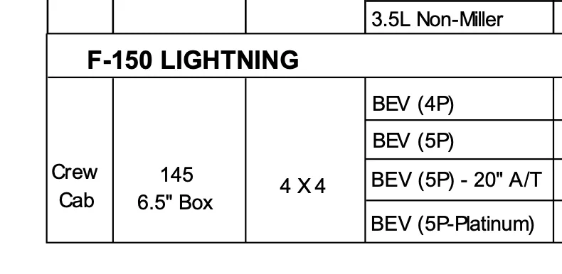

Reading through the charts...If the gcwr is 15000 pounds and the curb weight is 6500 then how is it supposed to tow 10k? Plat has a gcwr of 15900, but weighs just under 7k.

Not too sure how much you can bank on - one of the key pieces of information is wrong - it isn't a 6.5 ft bed.
