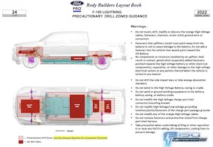

There was dim hope that maybe the base Pro model might have a single cab but it was wishful thinking:
https://www.fleet.ford.com/showroom...tning/2022/?intcmp=hp-showroom-f150-lightning
The Pro was revealed today, so every Lightning will have the same wheelbase/cab/bed configuration at least for 2022.
To get it down to reg. Cab short bed length would require some work because as seen in cutaway images as well as a walkaround of what they're calling the skateboard, the battery is integrated into the frame.
