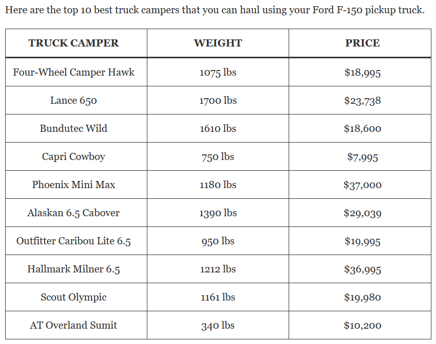

Was looking at a short bed camper for the F150EV but they all weight about 3k# and, if I read the specs correctly, the Maximum Payload Capacity of the Lightning is 2k#.
3,000 lbs really? I'm no expert in campers, but
https://campergrid.com/best-campers-for-ford-f150/
Ford F-150 Lightning Can F150 Lightning EV carry a camper? 1626795821454
I'm sure there are more elaborate and heavier campers, but I think that you should be able to find one that meets your needs and still complies with lightning limitations.

If your looking for a truck camper with solid walls, cooking, sleeping, toilet (and possibly shower) that you can drop the legs and drive out from under (to use truck for getting to site seeing places, or grocery runs once you have a camping spot) then you will need at least a F-250 or probably a 350 dually.
The weights in the chart above are generally dry weights. So you need to add for water, propane, gear, clothes, food, driver and passengers and any options you included on your base truck to get the total payload.
So add 200-300lbs for water, propane, food and gear. Then add 300-500lbs for passengers (2 adults at least, maybe kids?).
Now, if your good with mostly canvas and just a place to sleep in the bed for a night or two, then there are many options.
Great. I must have misread the wits. Those look like it will work.
