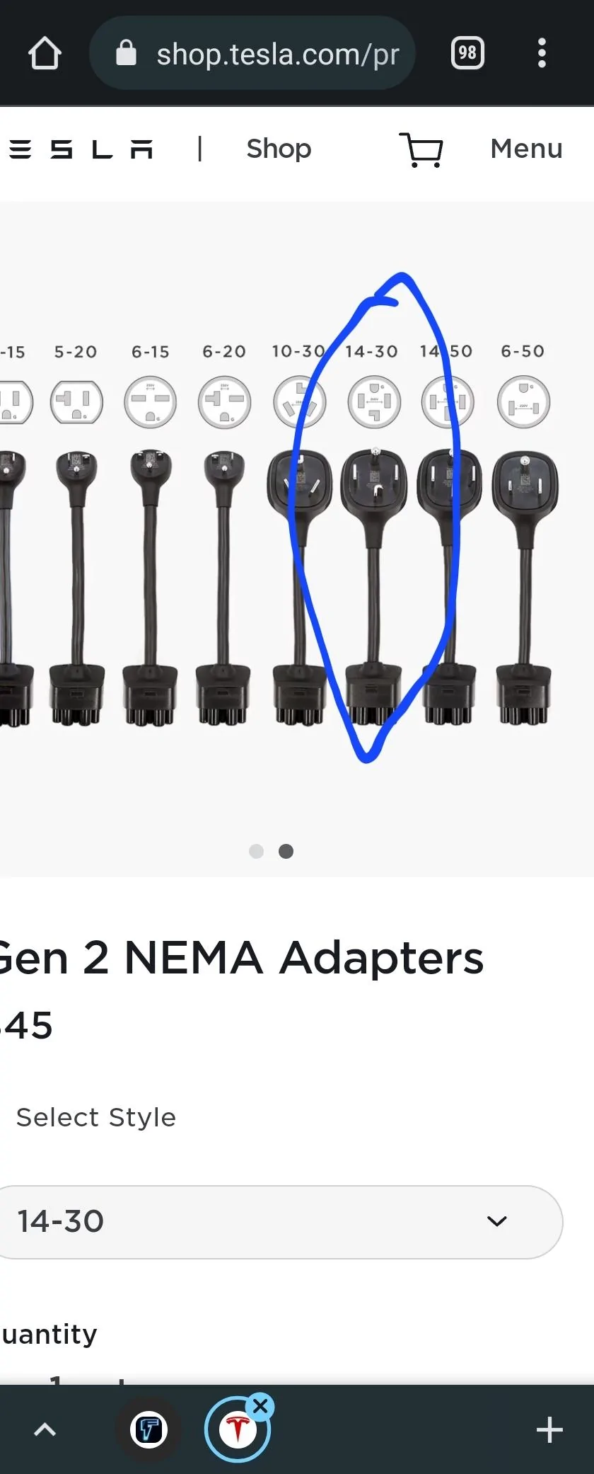

I just glanced and don't see an "L 14-30" on that Tesla page. You need a locking plug to go into the receptacle on the truck. You can see what they look like using the Parkworld Amazon link I posted. If you already have a Tesla 14-30, you could use a different adapter.
Does this not work?

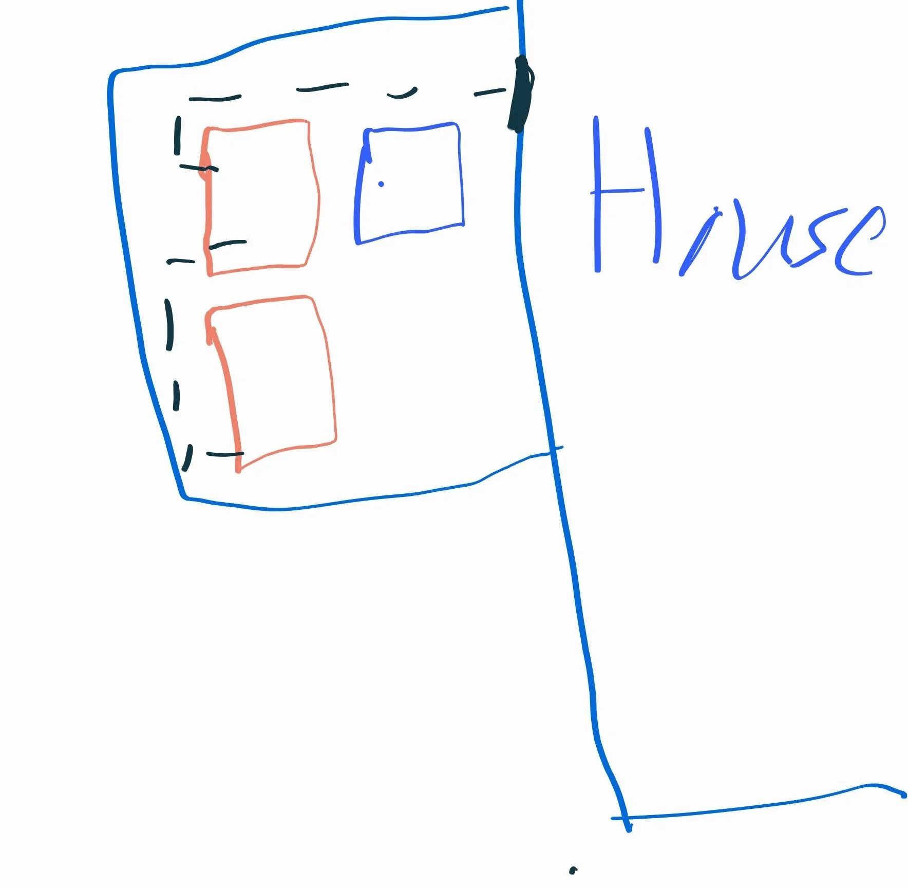

Valid questions! A mix of a few things - looking to keep costs low now, ability to really only draw 50 amps, and physical setup.
Our house is a multi family with a double wide, tandem parking. For reasons we don't want to change, the house is on the right of the driveway and we are on the far left of the driveway. The truck will be driveness and parked in front of the Tesla So with the truck pulled forward, we can have the charger lay on the driveway and not get driven over. If we run two EVSE I need on mounted at the end of the driveway and one about 20 feet further down the house. And the. The second one will cross the driveway and be driven over by their car daily.
We will eventually have two EVSE when we figure out the solar and backup power.
Additionally, as the F150 will be parked in front, not only would we have to think about which to plug in and play musicalchargers, we would have to swap the order for the cars very often to have the EVSE reach.
That is why I am hoping I can hop the truck, hope that explains some more!

Here is my terrible quick phone drawing... The blue car is then, the red cars are us. The black is what two EVSE would look like (with the second getting run over daily)

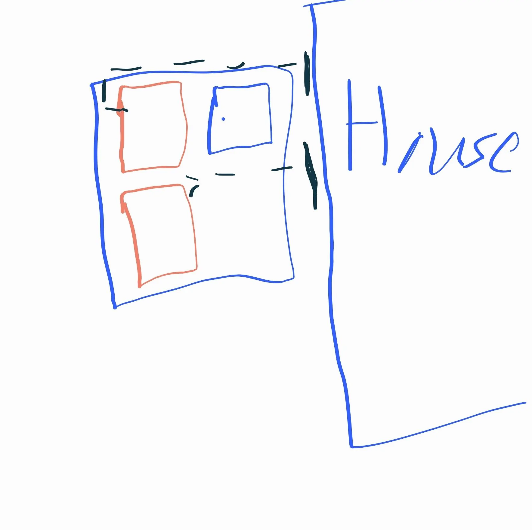

This is what I hope to do!
Again temporary as we sort out final plan

Tunnel conduit under the driveway midway between the two cars. Put in a post with the evse. This will reach both cars. If you still want two EVSEs run two circuits or a dual plug evse. Still not easy, but there will be no driving over a power cord.
They also make j1772 extension cables. It would likely be more efficient than AC to truck convert to DC battery, convert to AC from truck convert back to DC in second car.

It does help understanding that parking situation as I had just envisioned a simple garage or driveway parking. Best of luck in getting it figured out to do both. I would likely consider a 14-50 plug and a very heavy duty (properly rated) extension cord you could run to your side of the parking perhaps.
