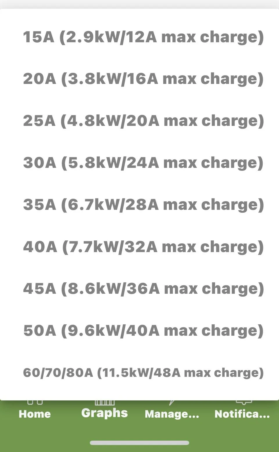

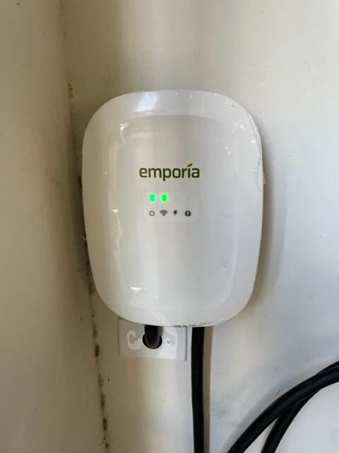

It may be easier to LOWER the amperage than to increase it. I set mine for 'hard-wired/20A breaker' because that's really all I need (until Lightning) with a long TOU rate window. I'm interested in seeing if @dirtdiver 's is also set to the lowest amperage.

It's structured to complicate the process so that it is not easy to increase the amperage once set.
Unfortunately, listing agencies and the NEC CMP want this, the idea being that users shouldn't be able to override potential safety features easily. They want EVSE's permitted to have variable max load configuration if done in a protected installer menu or via hardware DIP switch, but not easily changeable by the user once installed.
I understand it, it just makes life more difficult if it's portable and you want it adaptable to many situations.
