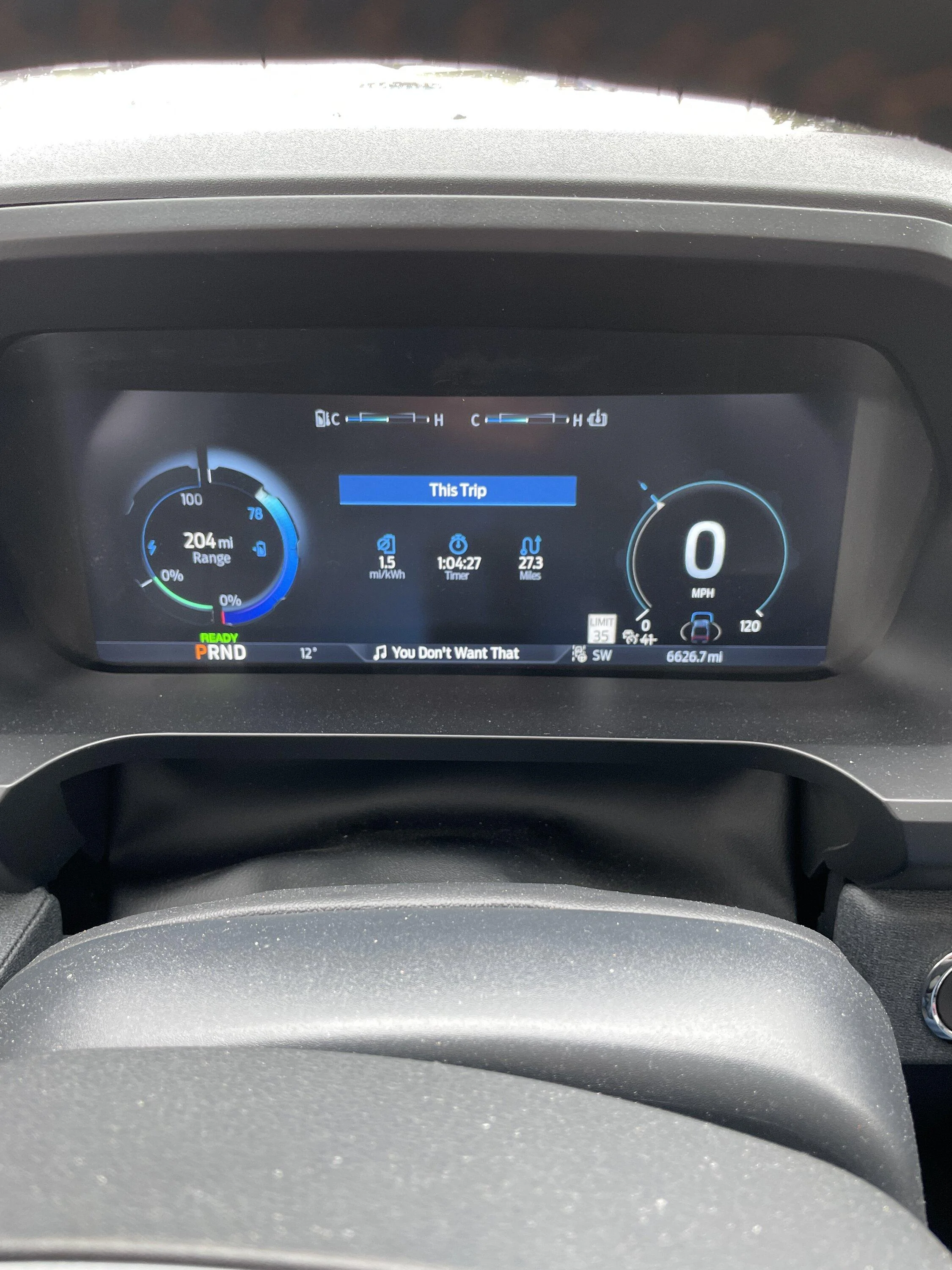

Does this reduction in power seem legit?

Is power still going to the front motor, or is this a uniform reduction of power to both motors?
I didn't even think to check..

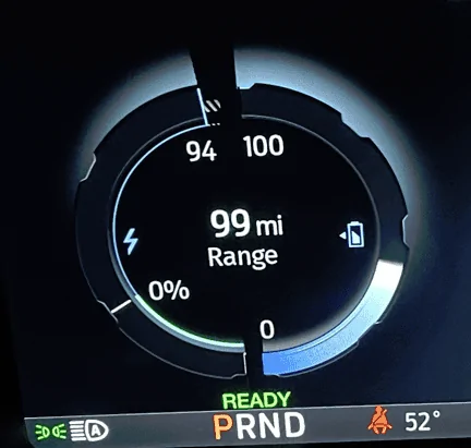

As an update this AM woke up to it still being reduced. A couple hundred more miles and temps went from low 20s to mid 40s, after another DCFC (3rd of the trip) my power reduction disappeared.
I’m still not sure why, especially since I’m seeing temps that are pretty regular for my area. The most likely is what @Pioneer74 suggested is I have symptoms of a failing battery cell.
As long as I can get back home I’m good, but this will mean Im likely shelving the Lightning when it comes to road trips until I can get it replaced.
