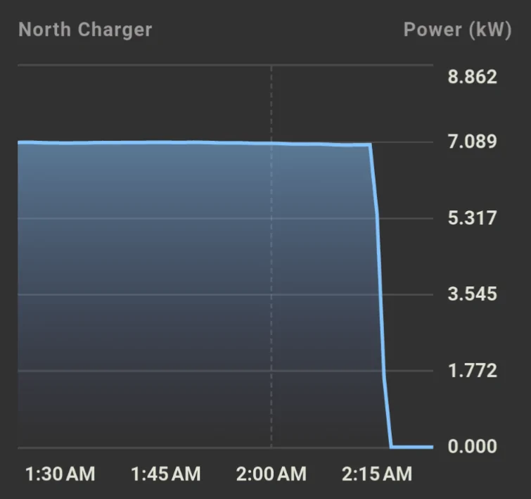

That is for DC fast charging.
For AC charging, the charge rate is pretty constant until a little before it is finished when it will ramp down at the end (see end of last night's charge below, EVSE was set to deliver 30A).
When charging to 100%, it will get to 99% ramp down to a lower power level for an hour or two while the battery management system performs a full cell rebalancing.

I knew I was close in my comment, but it would've taken me all day to analyze it. If you guys don't use AI, get it! Here's my analysis using Claude:
Good data, Calvin — I think we're both right, and your 30A detail explains it.
I ran the numbers on my own sessions (2025 Lightning ER, Grizzl-E at 48A/240V):
Level 2 home charging:
  1. 41% to 100% — 9 hrs 33 min — 72.6 kWh
  2. 40% to 80% — 4 hrs 59 min — 51.7 kWh
  3. 76% to 100% — 5 hrs 14 min — 29.5 kWh
  4. 39% to 80% — 5 hrs 10 min — 53.6 kWh
  5. 2% to 74% — 8 hrs 34 min — 87.7 kWh
  6. 52% to 100% — 7 hrs 46 min — 59 kWh
Below 80%, every session averages a constant 10.2–10.4 kW — maxed out, just like your flat line. But every session that ran to 100% averages way less at the top: comparing #1 vs #2 (same start point), the 80–100% stretch took ~4.6 hours for ~21 kWh — only ~4.6 kW average.
Your post explains where that time goes. If the truck holds full rate into the mid-90s and then spends 1–2 hours at low power doing cell balancing after 99% (as your graph shows), the math on my sessions works out almost exactly. So the "slow top end" I was seeing is mostly that balancing tail, not a gradual taper starting at 80%.
And the reason your graph looks perfectly flat while my averages sag: at 30A you're delivering ~7 kW, which is below wherever the Lightning's AC curve dips until the very end. At 48A (~11.5 kW) I'd catch any pullback under 11.5 kW that your setup can't display.
Bottom line for anyone reading: on the Lightning, DC fast charging tapers hard after 80% (my Supercharger data: ~139 kW avg from 21%, ~19 kW from 95–99%). Level 2 holds essentially constant until the high 90s, then plan on an extra hour or two of low-power balancing if you charge to 100%. Which is exactly what the next comment said after us. Have a great day!
