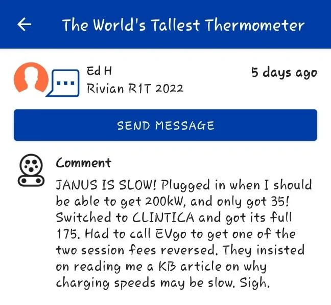

If you charged at the EV Go in Baker, many people are complaining about one of their chargers only putting out 35k.
Ford F-150 Lightning Charging flow throttled? Screenshot_20231109_110910_PlugShar

You should look those chargers up on PlugShare, they'll show if they have issues. That speed is the default "charger is broken" speed for EA.

Checkout the PlugShare check-ins for those locations and see if other people are also reporting the slow charging. As metnioned, EA chargers are often derated to 30'ish kW. It's incredibly annoying.
Look up reviews for a nearby charger that shows full rate and give that a try.
