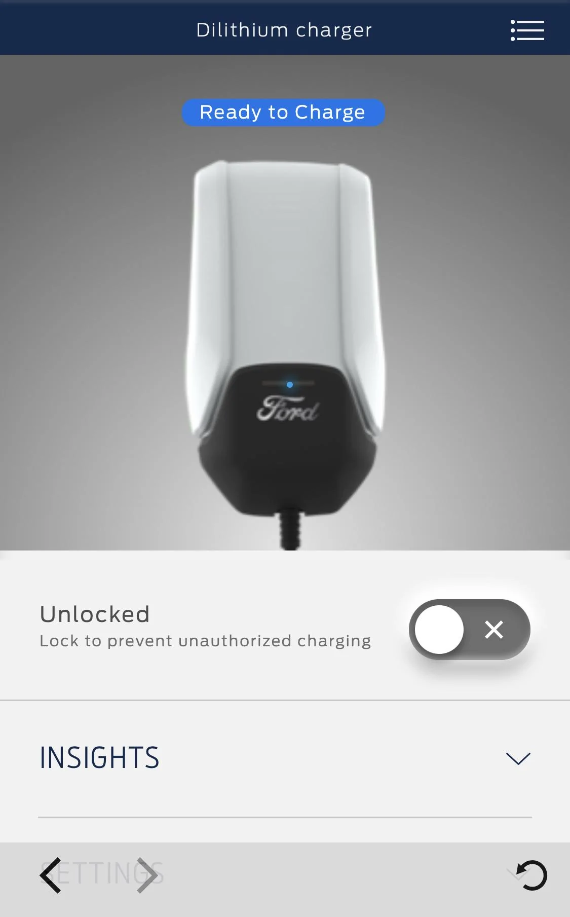

The FCSP in of itself has NO time controllers, if the OP wants advanced controls and metric, then other more capable EVSE's or related energy control / measuring devices are available.
