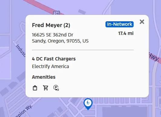

So my follow up question: Why didn't the electricify america charger just WORK when I plugged in. I see that is says it is IN-NETWORK. I had to do a payment method and all that crap seperately. Never did that before
Is Plug and Charge turned on in your app?
Why didn't you simply activate the charger with FordPass?
Unfortunately your frustration is 100% due to lack of knowledge. When you get up to speed, frustration is gone.

Plug & Charge is indeed on.
I don't recall having to do this the 1st time I charged. Yes could be my fault.... I think the App is horrible, but then again I am used to the Tesla App. So apples and oranges. I expected this to be like the Tesla where I just plug in and it starts charging. But I get it... it's a 3rd party network.

EA is indeed plug in and it starts, as well as Tesla, unless you were in Canada where EC isn't Plug & or Charge.
