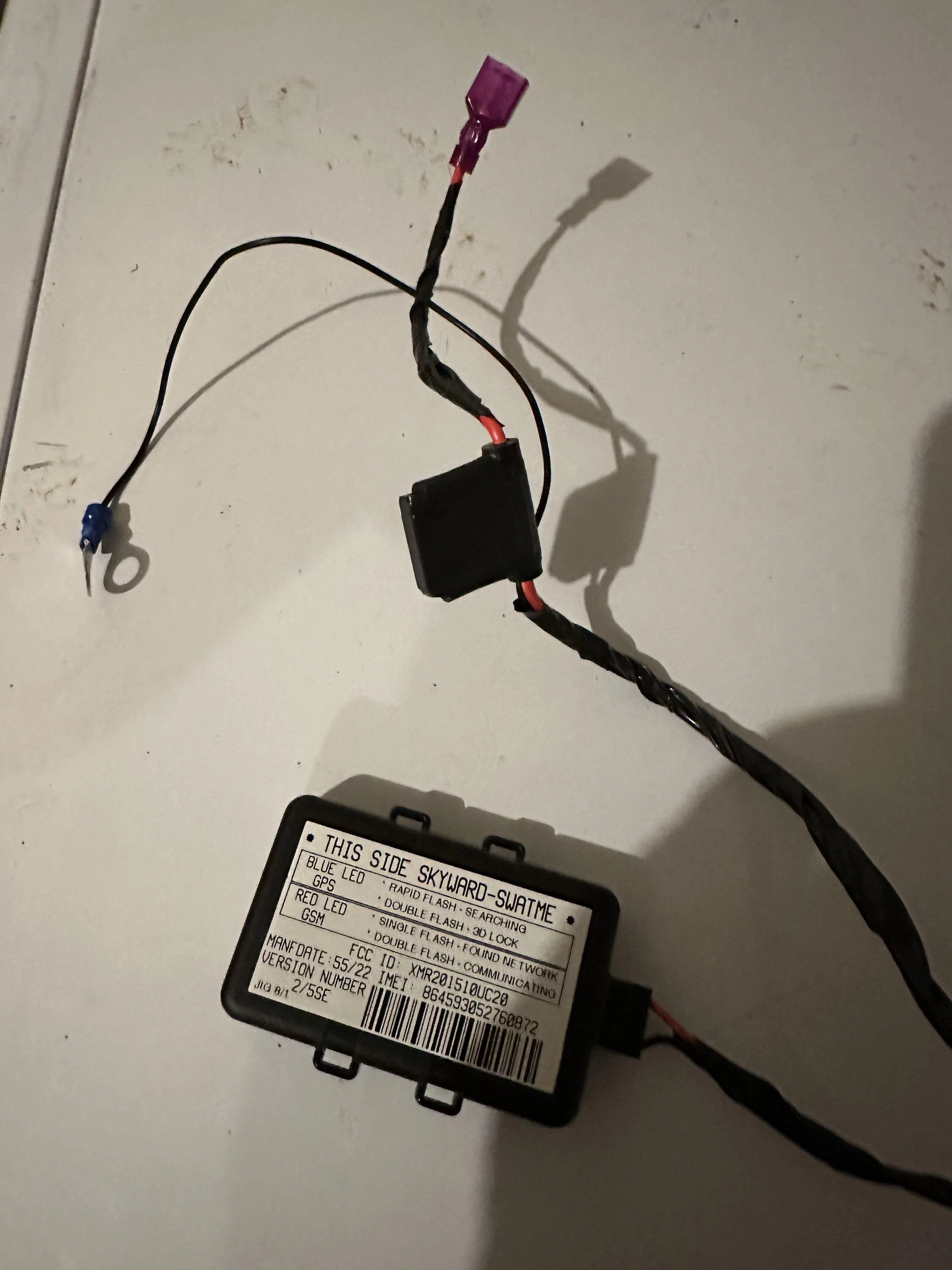

Got my Lightning late December, this just started earlier this week. When I turn the truck on I hear a chirping alarm sounding noise coming from the area around the headlight controls. When I first heard it, it wasn't even a full chirp. The next day it did a fill chirp, the next time 2-3 chirps. This attached video you can hear 9, and I just drove it again after the video an it did it 12 times. Any ideas what is causing it? I used the other fob this last time thinking it could be a security deal with a low fob battery. Maybe thats all it is and both batteries are low?

That doesn't sound like a Ford sound at all. Did your dealer add GPS or other device?

That definitely sounds aftermarket. I would check your paperwork to see if the dealer snuck something in on you.

If you can't pinpoint a speaker device look for extra wires added to your fuse box or spliced into a wire. The interior fuse box is in the passenger side floor, very easy to get to. You'll easily see any wires added in.

Mystery solved. Found the little bastard stealing power from by OBD-II

Why would they? Then they would have to admit that they already installed it and were going to go with the high pressure sale of it's already installed so we have to include it. I'm actually shocked @biers got them to remove the charge for it

My 911 had this as well. A lot of dealers put them on ALL their vehicles.

I preemptively opted out of all that stuff long before delivery, and reminded them of it about a week before it arrived at the dealer. They didn't charge me for it obviously, and I don't think they had it in their custody long enough to install anything.
But I'm still going to look around. Because I know they do stuff like this. If they can install a tracker, they can potentially sell that info to your finance company as a repo/recovery mechanism. I'd imagine there is a whole kickback infrastructure for such things.

This was my thought, what do they have access to without telling the consumer. It's a long stretch, but this is what it will take - if you could prove it was being tacked without your knowledge, you'd probably have a pretty good case worth millions agains the dealer, and it might stop some of the stupid crap that makes them stupid money.

Glad you guys found out what this is. Same thing happened to me as the sound ramped up over the last few days. Is this the SWAT system that they offered to me? I declined it as well.
